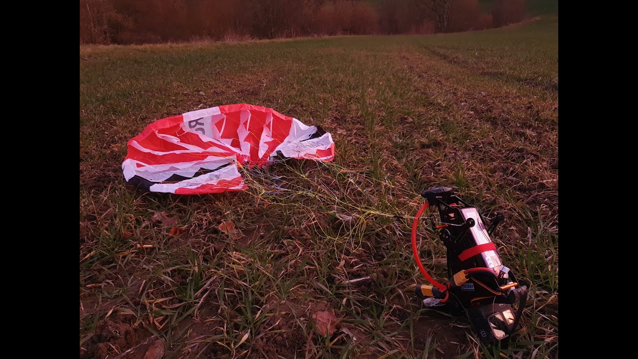

Flight 1
After practicing the launch sequence with Leo, we finally tried the first flight, which ended quickly as the ESC decided to stop accepting input (I suspect?), and cut the throttle off.
Then we launched again, which marked the first successful take-off of the RC Paramotor with PX4 onboard! :tada:. It was a nerve-wracking & exciting flight, as the wind was gusty (1~3 m/s), and parafoil was shaking often quite aggressively. However, it was possible to land without big scratch (just cow poop).
flight log: Flight Review
Flight 2
After the excitement of flight 1, we prepared and launched again. After which I saw the paramotor roll to the right aggressively & had to abort the flight with a bit of a hard impact on the ground. Few of the lines got tangled around the motor, but it took just 2 minute to get everything set up correctly again! (I guess being a paraglider pilot helps :smirk:)
