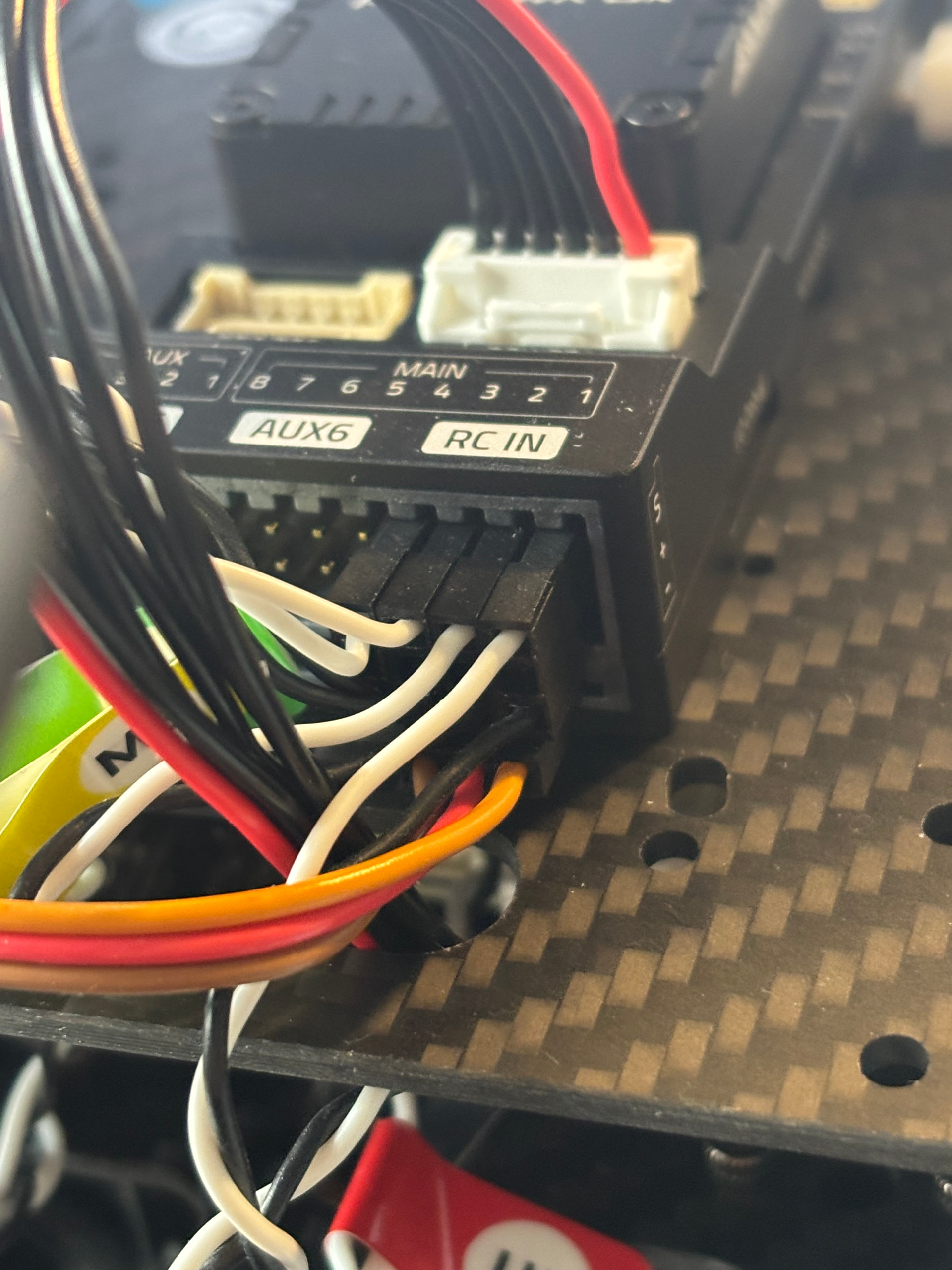

@Igor_Misic I am a new drone builder as well. I built the X500 v2 using PixHawk 6x. I tried to do the test in Actuators to spin the motors but they did not spin. Please see the connection to Pixhawk 6x below image. Any help is much appreciated.
Thank you,
Mustafa
