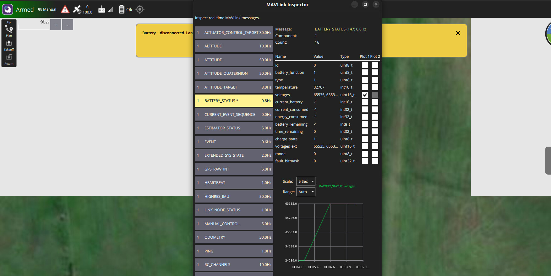

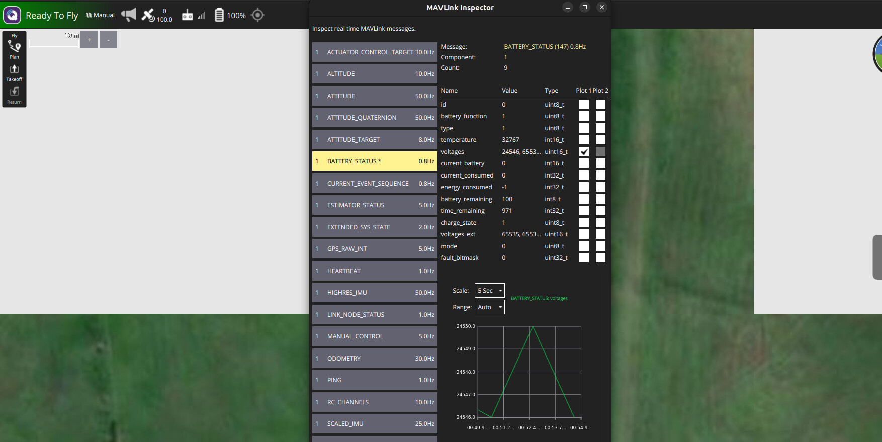

Please see link to log file in flight review and screenshots. This was done from a test inside, so there was no gps lock, but the QGC in disarmed state says battery 100%, as soon as I arm it, it says battery disconnected.
Link to log file: https://logs.px4.io/plot_app?log=13a0574d-6e1b-4464-861d-19819f8e5f37
Screenshot of QGC in disarmed state (battery correctly showing 100%)
Screenshot of QGC in armed state (Battery shows OK, but battery monitor shows charge, battery disconnected error showing)
Is this log with the power module connected? I don’t see the voltage of the battery. I only see the 5v from USB.
