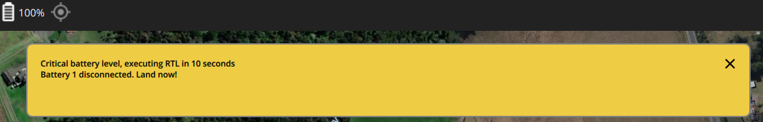

Issue 2 - battery failsafe activating on full battery
The battery failsafe activated several times, either saying low or critical level had been reached, or the battery had been disconnected despite their being a full battery, and the status bar icon showing a full battery. See attached pic.

I have a few suggestions but assuming all cables are connected properly, would you be have access to a multi-meter? Hooking this up and doing a sanity check would be my recommendation. I will mention, upon looking this module up, can you double check the instructions here? https://docs.holybro.com/power-module-and-pdb/power-module/analog-power-module-setup

But I am still getting battery failsafe activations due to the critical level or warning level being met and QGroundcontrol saying battery is disconnected, despite there being a full battery.

How is this concluded? Or anyabody had similar problem?
I also get continous battery fail warnings.
I also get this during properller removed state, thrust test at ground.
QGC reads battery %80+ all green. We have conducted successfull RC flights. But autonome modes fail due to “critical battery level” failsafes. (We dont want to modify failsafe conditions)
Very strange that only reported for 6cMini
6C Mini, PM06v2-14, px4 fw 1.14.3 to 1.170alpha
  1. Voltage Divider: 18.182
  2. Amperes per Volt: 36.364
Battery: LiPo 22.2V, 6S, 45C
(tried with same spec, different phsical bats, same result)
