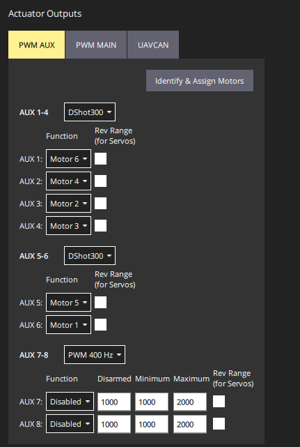

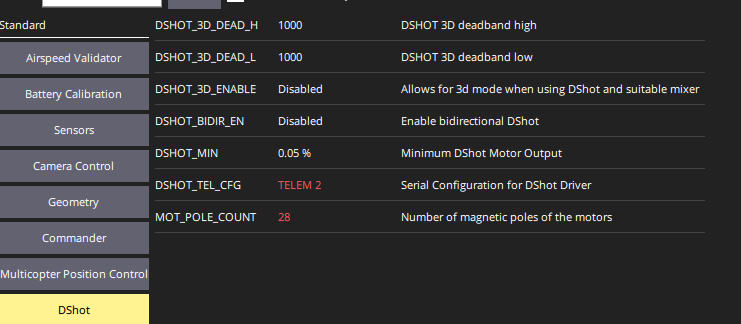

I’m testing ESC telemetry with PX4 and can’t get it working.
Hexa Copter with Pixhawk 6C FC
2x TBS Lucid 6S 4in1 ESC (3 motors on each ESC)
Team BlackSheep Online Store - TBS Lucid 6S 4in1 ESC -
Motors connected to FMU PWM OUT (AUX)
PX4 Pro v1.16.0 (stable release)
ESC firmware: AM32 v2.19 (30 ms telemetry enabled in configurator)
Using DShot300
Telemetry pins from both ESCs joined and connected to Telemetry 2, there is no mistake in the wiring as I was able to get telemtry on ArduPilot.
Current status:
Motors run fine with DShot300.
Telemetry does not work in PX4.
I am getting the follwing responces in MAVLink console
dshot esc_info -m 1
ERROR [dshot] Packet length mismatch (64 != 15)
nsh> dshot esc_info -m 1
ERROR [dshot] Packet length mismatch (40 != 15)First is with both esc boards connected the other one is with only one.
I cant understand what am I missing out. Any help is very appreciated.
