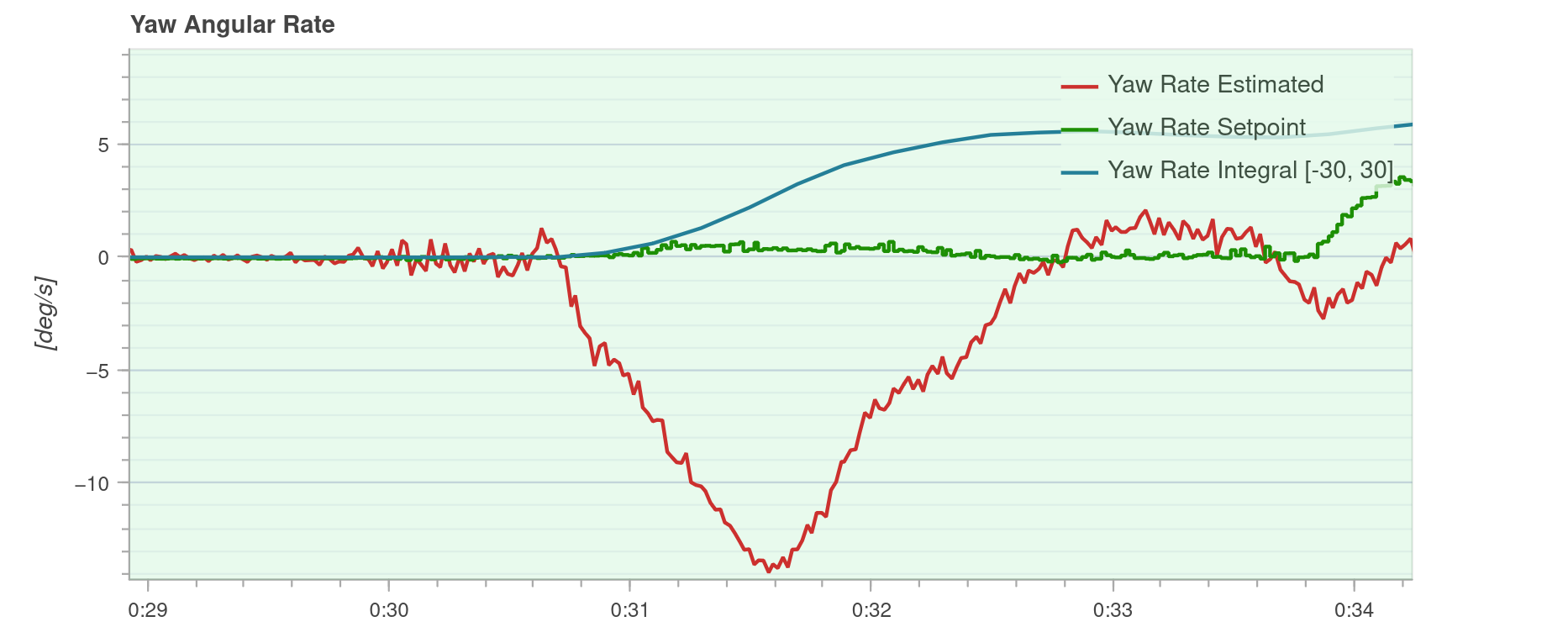

I’m inquiring about a slight problem after setting up the fabrication machine.
When taking off in position mode, the yaw direction is slightly shifted to the left to take off. If you turn it back toward the front, the yaw direction is no longer reversed.
Stevilize, there is no problem in altitude mode.
It seems to be a problem caused by the vibration of EKF2, but it is not accurate.

You mean this, right? Yawing on take off?
Check the angles of your motor mounts. And try angling them, so they slightly help with yawing, like explained here, just not as extreme:

It is said that the drone will take off with a slight yawing to the left when taking off, but the rotational phenomenon disappears after taking off.
Is it right to view this as hardware, or should it be viewed as a yawing phenomenon at takeoff?

Think through it. The yawing effect is counter to the rotation of the propeller. Based on that you can then figure out which way to tilt it.
