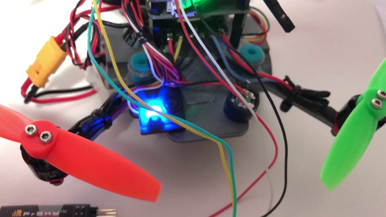

Hi, everyone!
I’m trying to setup a sub 250g mini drone that uses a Pixracer R14 flight controller running Ardupilot firmware. Everything is okay, except FrSky telemetry. My first try was using FrSky R9M module and R9Slim receiver. I tried for 2 days and gave up, because telemetry did now work.
Now, I’m trying using my Taranis X9D+ connected to a X4RSB receiver, all with updated firmware. My connections can be seen in the 1min video I’ve recorded right now specially for this post (link below).
I followed every single step in the PX4 instructions page, and tried some variations too, but without success. So, I really hope somebody can help me. I will use this drone for my PhD experiments and I need this working as soon as possible… :frowning:

SOLUTION FOUND!
I just setted the paramenter SERIAL4_PROTOCOL to 4 and started receiving all 13 telemetry values from Pixracer R14 running Ardupilot/Arducopter 3.5.7. The receiver is X4RSB. Now I will try with R9Slim receiver.
Regards!
Hi, again.
Not working with R9Slim receiver. Any idea?
