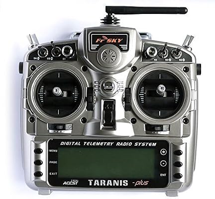

Transmitter: Taranis X9D Plus

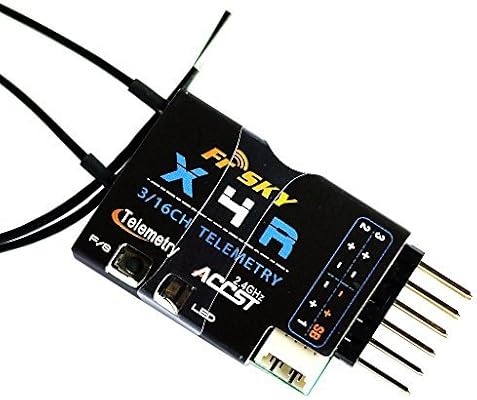

Receiver: FrSky X4RSB 3/16CH Telemetry Receiver with Futaba SBUS 16 Channels Smart Port

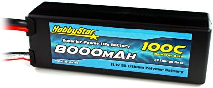

Batteries: 9S Configuration, 8000mAh 100C
