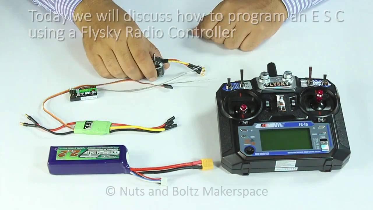

To check if the motors and ESCs are healthy I have also tried manually calibrating every motor and ESC combination. However, even that has failed. So I have been unable to see a single ESC or motor in action.
I am using this procedure:
