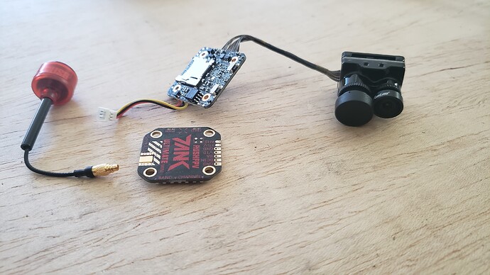

Thanks for the info on the GPS LEDs @jimdgit. By any chance, do you have info on connecting cameras to the PX4 / PM07 board?
I’ve resorted to strapping my EKEN 4K camera to it and hitting record. (SIDENOTE: on the time I first took it out my drone seemed to have power surges and eventually it began to lose altitude and finally crashed My PX4 drone crash video link). Any thoughts on what happened here?
Anyways, I have my RUNCam Dual Hybrid camera and a RUSH Ultimate Mini FVP tx. My goals are to:
BEC:
  1. Be able to turn on the camera from the FrSky Taranis Q X7S (or is there a different way that it’s typically turned on? Can the FrSky be used to hit a snap photo button?
  2. How should this be wired? I see I have power/ground/and signal.
  • My current expectations is that both the RUSH tx and the camera need to be powered independently. Where should these be going, to the PM07? To a BEC? The BEC has 5 wires just to add to the confusion on my end.
  • Then the Signal from the camera is going to go (?) to the PM07 board PWM pin 5 or 6? Is the set of pins powered (I believe not) and of not then how should I be providing the power and ground to this group?
  1. I’m assuming once the board and the PX4 see something is connected to pin 5 or 6 I will then see it on QGroundControl.
  2. Once the Rush tx is powered up will it be sending out a signal that my Flysight Black Pearl RC801 FPV Monitor (https://tinyurl.com/yxngyuyy) will be able to pick up on to view the signal?
That’s it for now, I’ve been working away on learning the needed steps over the past month, here’s one of my more detailed requests for help!
Thanks in advance,
Louie
