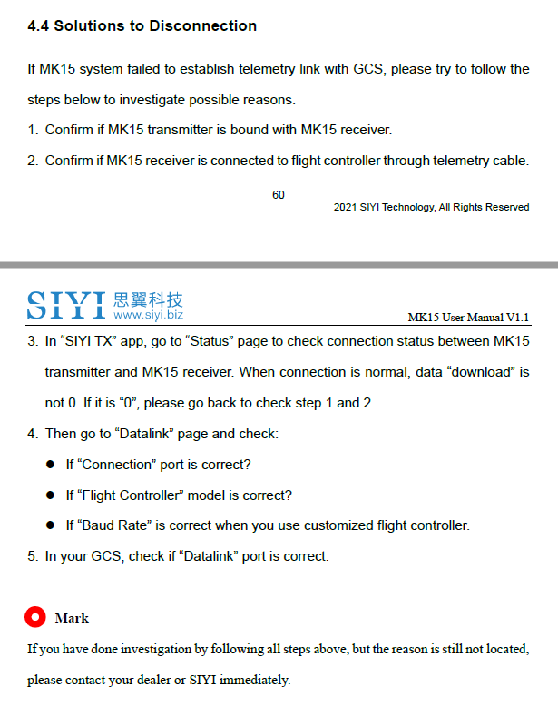

Hi, I’d like to connect my Windows PC to the drone with AK28 via bluetooth.
I can get data from my drone with terminal software.
However, QGC Apps on the Windows PC says “MAVLink Baud Rate Mismatch”
What should I check more ?
-firmware version V1.0.9
-Baudrate 57600
-Flight Controller APM/Customize
-Connection Bluetooth
There is a normal process to investigate this issue. Welcome to refer to the below steps.
In your case, we assume that it would be the telemetry cable or the baud rate.
