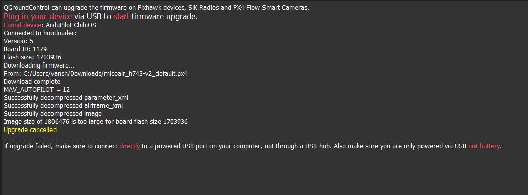

  • Issue: QGroundControl cannot find/detect firmware for this board
Problem: When I try to flash PX4 through QGroundControl’s automatic firmware selection, it doesn’t show any firmware options for the MicoAir H743 v2. The board isn’t appearing in the standard PX4 board list.

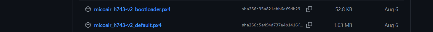

  2. Which PX4 build target should I use for this board? (mro_x7pro? holybro_kakuteh7?)
  3. Do I need to manually download a .px4 file and flash it via custom firmware?

i found these two but the QGC gives error
The target was added after the 1.15 release and has not been back ported. You’ll need to contact the manufacturer.
The manufacturer’s website provides firmware version 1.15.2. In my case, I added a separate target for version 1.15.4 and built it myself. You can also take the board target from version 1.16 and build it with the 1.15.4 firmware — it works without any issues. Hope this helps.
