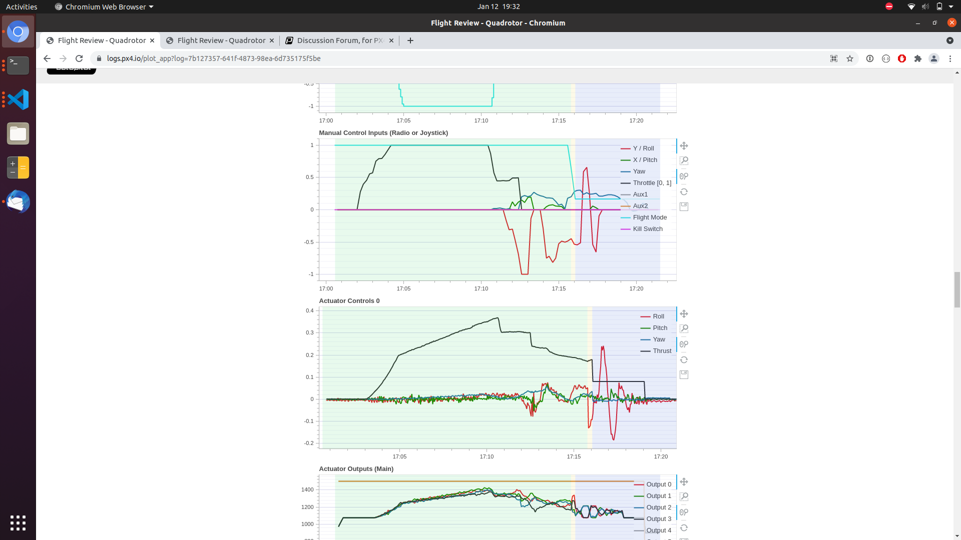

i have a drone running px4 v1.12.3.
in position mode when i try to takeoff, using a remote control, in position mode. nothing really happens.
it arms ok, but when i lift the stick, the motors just spin up very slowly.
i am also not able to start offboard mode (command denied error response from mavsdk).
this only happened after takeing off and landing using mavsdk. but only sometimes. after reboot everything is good again.
can somebody help clearing up this issue.
https://logs.px4.io/plot_app?log=7b127357-641f-4873-98ea-6d735175f5be

Yep, 100% throttle.
And when i do so, it takes about 10 seconds, to reach hover throttle.
This is after I stop offboard, so these requirements should not matter.
By the way, attitude and stabilized mode work without a problem.

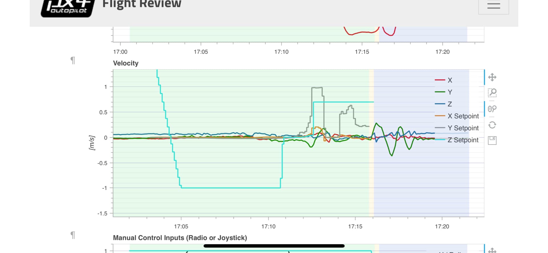

The problem isn’t physical, the drone is able to fly. After a reboot.
But event when commanded to takeoff, nothing happens. (Dark blue line should follow light blue) I think this might be a bug. But it’s very hard to tell what causes it
