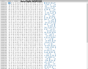

I captured the MSPOSD data of PX4 and Ardupilot, and they look very different,
The MSPOSD of Ardupilotis working properly, perhaps the MSPOSD protocol of PX4 is outdated?
This is the MSPOSD data from betalight, it’s same format as Ardupilot.
I am confident that if you want MSPOSD to work, you need to inmigrate betalight(Or ardupilot) OSD protocol as @sastel mentioned.
 24 4D 3E 01 B6 04 B3
 24 4D 3E 01 B6 00 B7
 24 4D 3E 01 B6 02 B5
 24 4D 3E 04 B6 03 0D 14 00 A8
 24 4D 3E 0A B6 03 0A 15 00 15 2D 30 39 2E 31 8E
The message function filed( message[4] ) in betaflight and ardupilot are all B6(182)

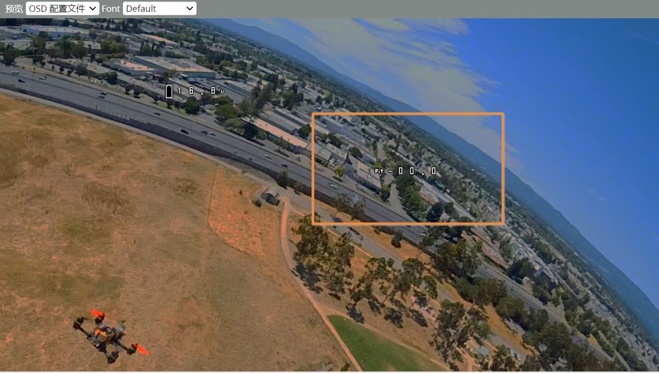

I have analyzed the MSPOSD drawing process of the latest betalight.
If you want to draw the pitch in OSD, such like in the picture above.
The complete data flow is as below. it’s base on subcmd in the message[5].
