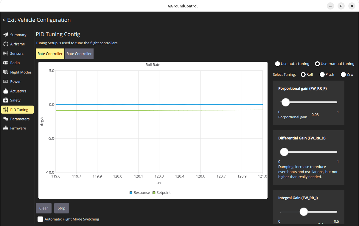

I am using the QGC version v5.0.8
There too PID Tuning for fixed wing mode not available!
It is really difficult to even tune manually without that tab.,
@Jaeyoung-Lim Need your help !
Same for MC and FW. It depends on which flight mode you are in right now.
@Mahima_Yoga any idea?
Can you give some more context? For me in SITL (make px4_sitl gz_advanced_plane) on PX4 1.16 and QGC v5.0.8 the tab shows up.
It is working fine for fixed wing and multirotor. I am facing the issue for VTOL.
Please try make px4_sitl gz_standard_vtol
It will show PID Tuning only for Multirotor.
No option to tune (even manually) for fixed wing controllers.
Ah right - I tried it just now.
It’s definitely not as user friendly as the pure MC/FW vehicles, but I think once you transition to FW the plots show the fixed-wing rate and attitude setpoints/measurements (even though the tab says “multicopter”.
If you want to use autotune, I would recommend you engage it through RC (see docs)
Was there anything specifically that you were looking for regarding the fixed-wing tuning interface that the multicopter one has for the vtol vehicle?
This is good to go for autotune.,
Yes it is., But to do manual tuning while flying in FW mode, it might be helpful if we have relevent gain sliders instead of MC gain slider.,
