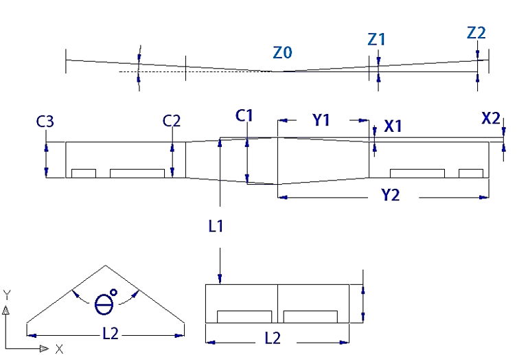

The application was developed using Python, while the Tkinter library was used to create the graphical user interface. The interface enables the user to enter the aircraft’s geometric and operating parameters, including the wing area, wingspan, root and tip chord lengths, wing position, and incidence angle. It also allows the user to define the dimensions, position, and cant angle of the V-tail relative to the aircraft coordinate system.

After the required data are entered, the application automatically generates an aircraft geometry file in a format compatible with AVL. The generated file contains the aircraft reference parameters, lifting-surface coordinates, panel discretization settings, and the locations and control gains of the control surfaces. Python then launches the AVL executable and automatically sends the required sequence of commands to the solver.
