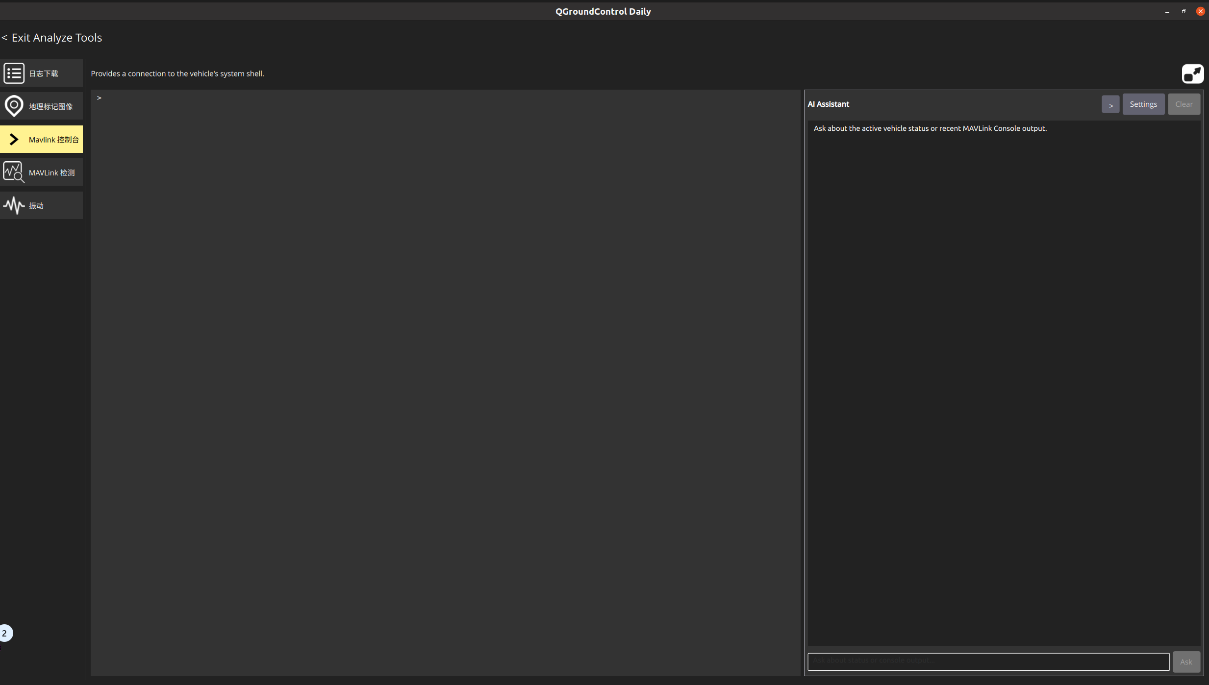

3. Current capabilities

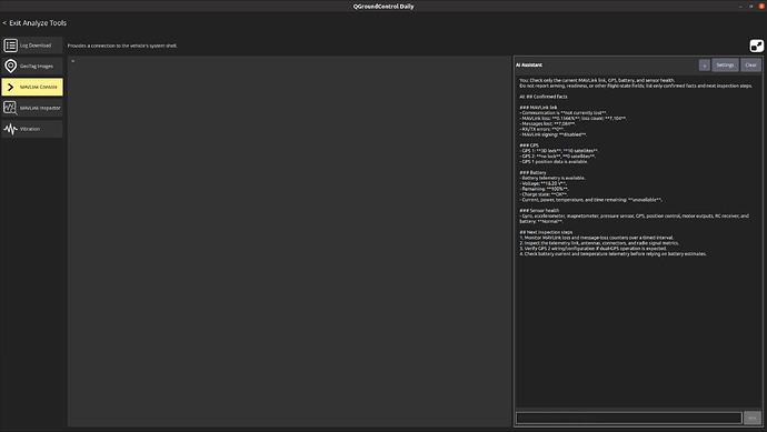

The AI Assistant is integrated into the MAVLink Console page. When the user asks a question, QGroundControl can provide the AI with:
  • A snapshot of the active vehicle
  • Structured telemetry from QGroundControl FactGroups
  • Loaded PX4 parameters and their descriptions
  • Health and arming-check reports
  • MAVLink link, communication-loss, and packet-loss status
  • Recent MAVLink Console output
  • Restricted query results generated for a specific PX4 diagnostic question

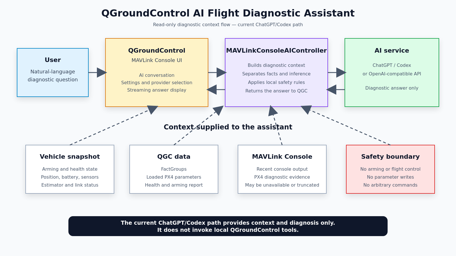

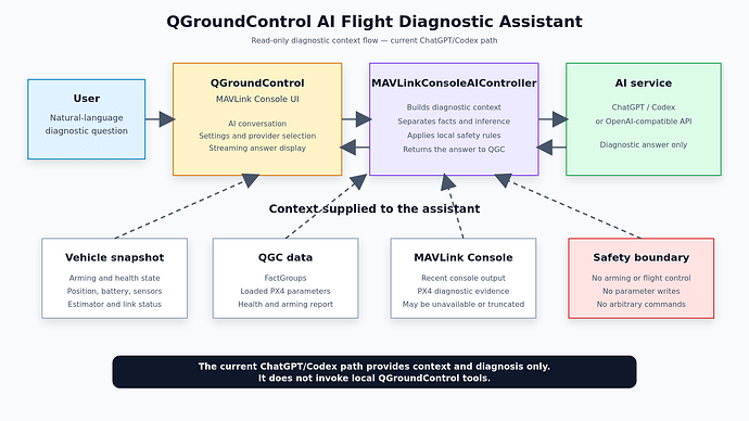

4. Architecture and data flow
The current implementation can be summarized as follows:
User question
QGroundControl MAVLink Console page
MAVLinkConsoleAIController
    ├── Active Vehicle snapshot
    ├── FactGroups, parameters, health and link status
    ├── Recent MAVLink Console output
    ├── PX4 diagnostic evidence builder
    ├── ChatGPT/Codex path: context and diagnostic answer only
    └── OpenAI-compatible API path: whitelisted tool executor
      Controlled tool results on the API path, or a read-only ChatGPT/Codex answer
Figure 2 shows the current read-only ChatGPT/Codex diagnostic flow: QGroundControl provides vehicle status and MAVLink Console output to the AI, and the AI only returns an analysis. It cannot invoke local QGroundControl tools or control the vehicle.
For an OpenAI-compatible API that supports tool calling, the AI can only request whitelisted diagnostic data. Before a request is executed, QGroundControl validates the tool type, arguments, vehicle state, and command contents locally; user approval is also required when applicable. Requests that violate these rules are rejected, so the AI cannot change parameters or perform flight-control actions.

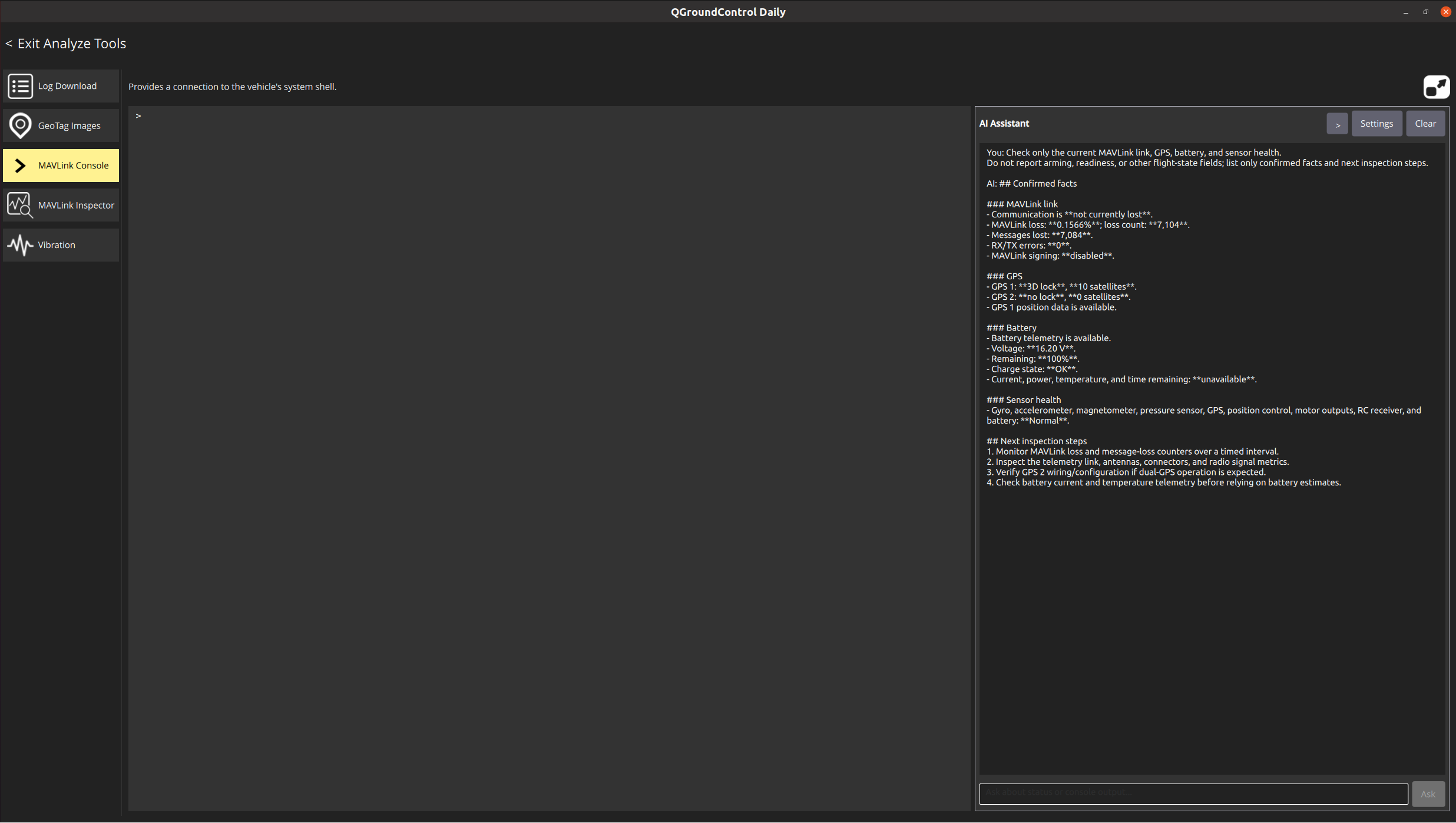

5. Example of PX4 diagnostic evidence
Figure 3 shows a SITL diagnostic conversation on the read-only ChatGPT/Codex path. Using status context supplied by QGroundControl, the assistant summarizes MAVLink link, GPS, battery, and sensor health, then provides safe next inspection steps.
The broader design goal is to separate diagnostic evidence into layers rather than draw a conclusion from a single status field. For a PX4 question, the AI should distinguish direct observations, different data sources, configuration state, runtime state, and health state.

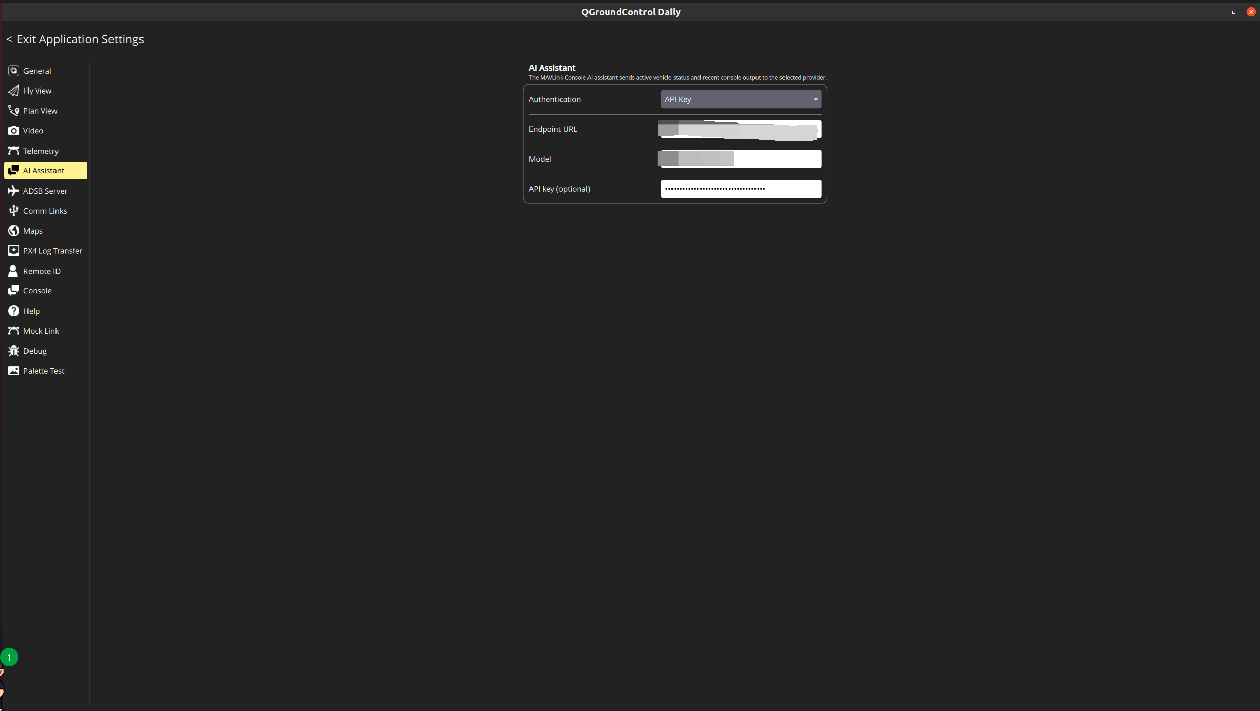

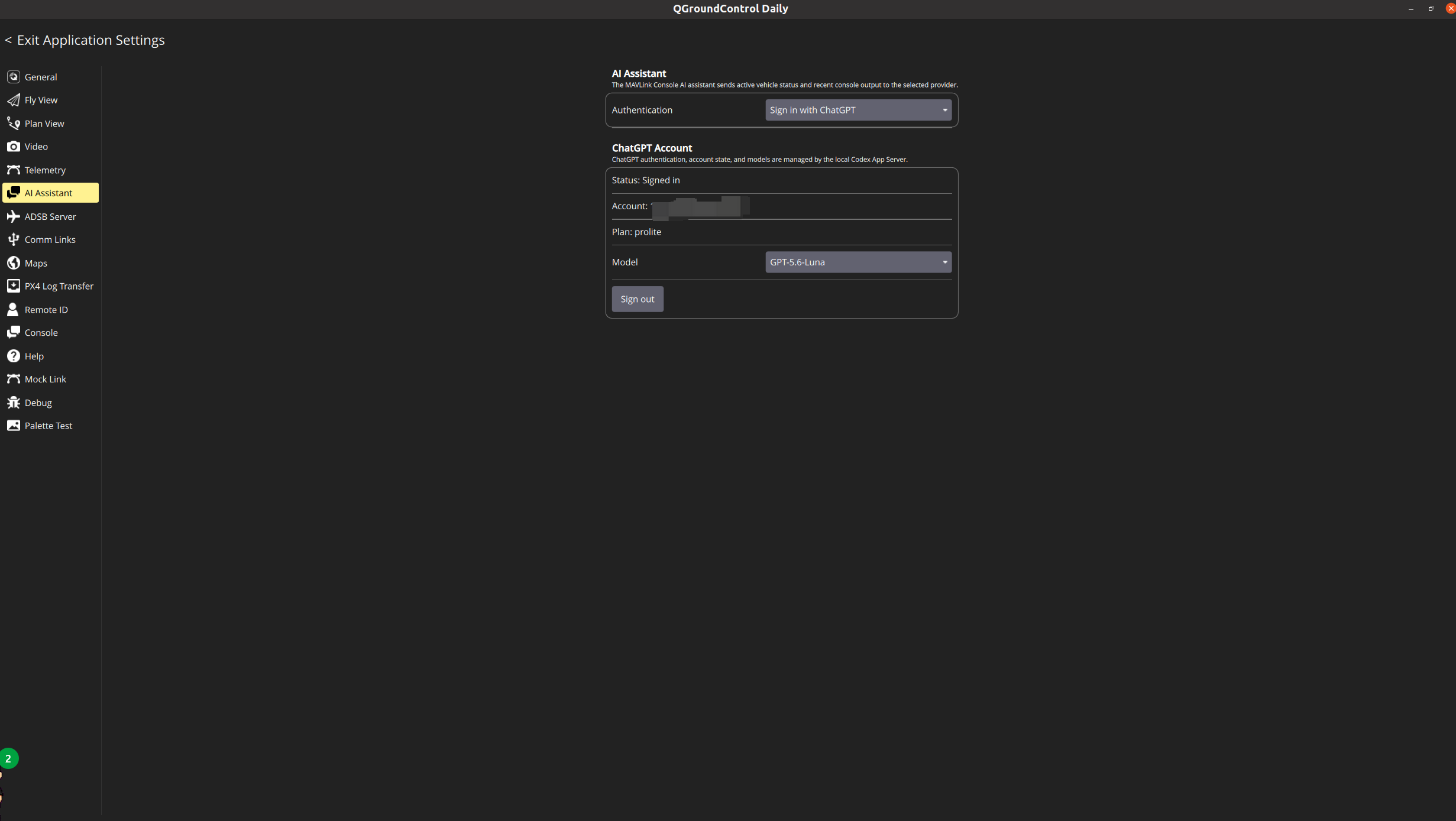

7. AI service configuration and data boundary
The current settings provide two configuration paths with different tool capabilities:
  1. An API key and an OpenAI-compatible Chat Completions endpoint. This path currently supports experimental controlled tool calls, constrained by a local whitelist, vehicle-state checks, and user approval where required;
  2. ChatGPT sign-in through a local Codex App Server, followed by model selection. The current path sends status context and receives a diagnostic answer, but does not request local QGroundControl tools or approvals.
When a remote AI service is used, the active vehicle state, recent Console content, and relevant diagnostic results become part of the request context sent to the selected service. Users should decide whether to enable a cloud service based on their network environment, data sensitivity, and the applicable service terms.
The prebuilt package will not contain an API key, ChatGPT login state, or personal configuration. For testing, use a dedicated test account and avoid entering secrets, internal addresses, or other data that should not be sent to an external service into the Console.

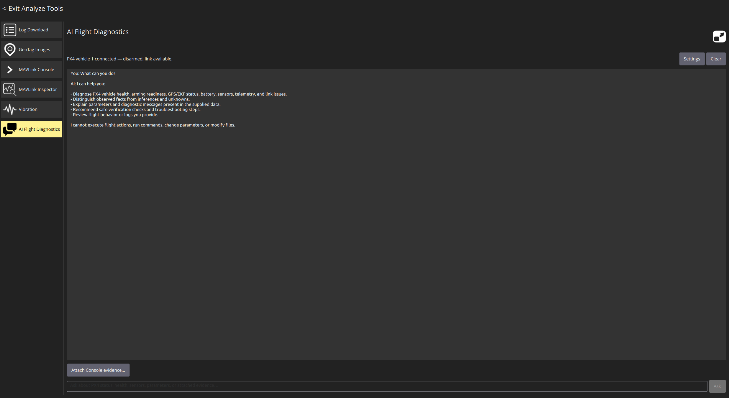

A small progress update based on the feedback above:
I have moved the prototype out of the MAVLink Console and into a dedicated AI Flight Diagnostics page under QGroundControl’s Analyze Tools.
The current prototype is still PX4-focused and experimental. It provides read-only diagnostics, displays the connected vehicle state, and allows PX4 Console output to be attached as optional diagnostic evidence.
This is still an early UI direction, so I would really appreciate any feedback:
  • Does Analyze Tools feel like the right place for this feature?
  • Should the interface remain conversation-first, or start with a structured vehicle health summary?
  • Which diagnostic scenario would be most useful to demonstrate next?
    Any suggestions on the layout, workflow, or diagnostic information would be very helpful.
