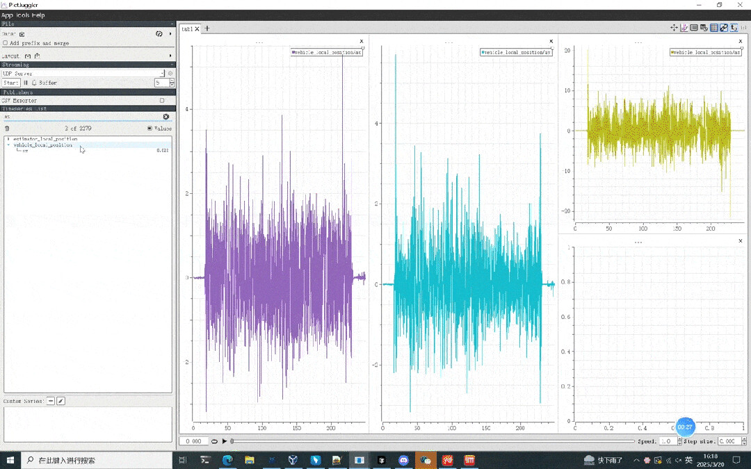

1. Multi-Window Synchronized Display - Eliminate View Switching
Using horizontal/vertical split-screen technology for synchronized multi-parameter monitoring with practical applications:
The analysis interface divides into three independent views:
  • Flight attitude data (X/Y/Z axis acceleration)
  • Vertical velocity curves (right panel)
  • Battery current parameters (bottom center)
During drone takeoff, current surges precisely correlate with acceleration/velocity fluctuations on the timeline. This multi-dimensional time-series analysis:
  • Reduces misdiagnosis from single-parameter views
  • Clearly visualizes the “power output→motion response” causal chain
  • Improves fault diagnosis efficiency by 60% compared to conventional methods

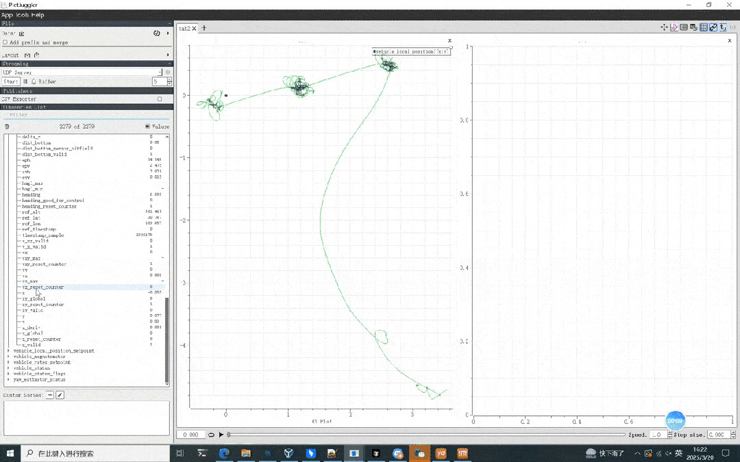

2. 2D Trajectory Mapping
Create XY scatter plots via Ctrl+right-click drag to convert time-series to spatial trajectories:
Key features:
  • Plot vehicle_local_position x/y coordinates for trajectory projection
  • Synchronized display of vx/vy horizontal and vz vertical velocities
  • Real-time playback control (0.1-10x speed) for dynamic analysis
Practical benefits:
  • X-axis acceleration shows vx positive-phase growth
  • Y-axis turns produce immediate vy response
  • 80% faster identification of drift/integration anomalies than single-dimension analysis

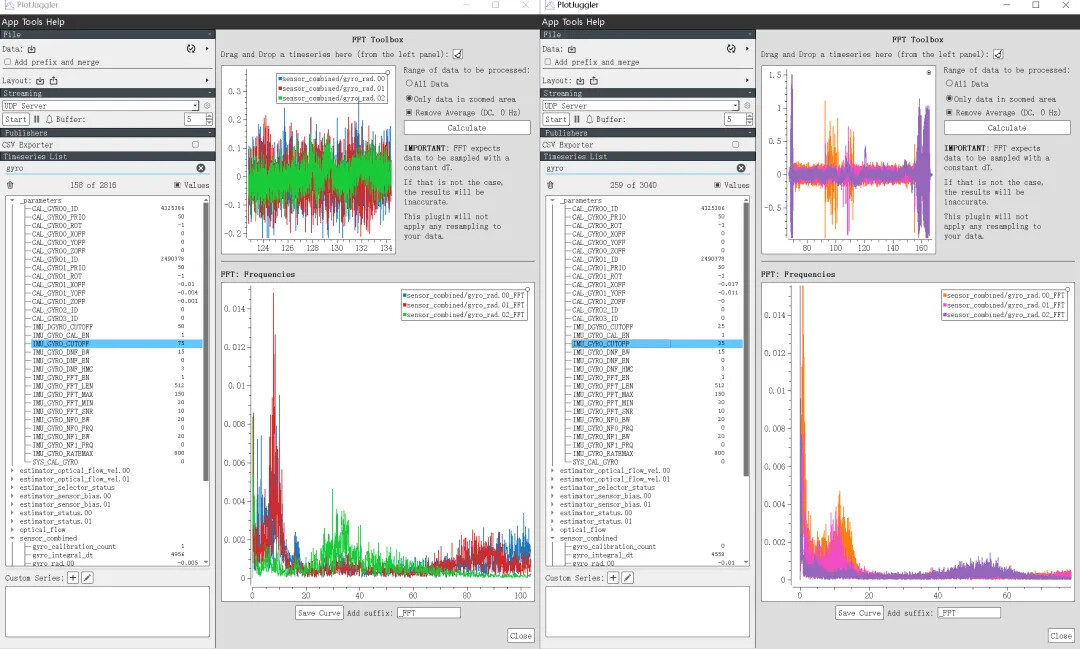

3. FFT Transformation
Built-in Fast Fourier Transform with one-click vibration spectrum generation:
Workflow for vibration analysis:
  1. Identify resonance frequencies via FFT
  2. Set cutoff frequencies
  3. Observe filtering effects without data export

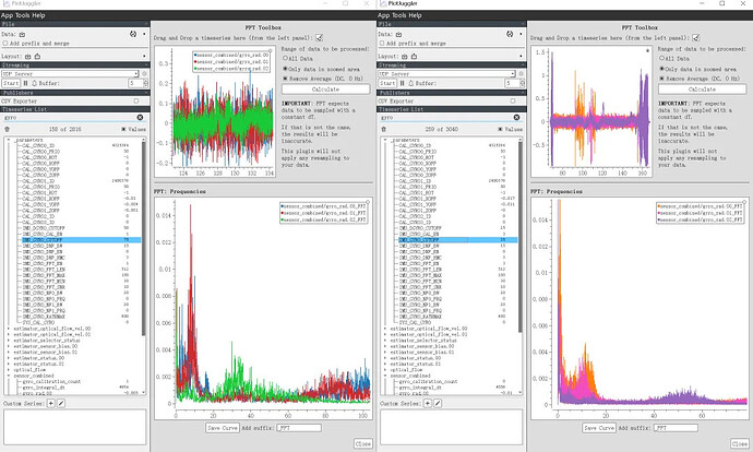

1. Vibration Analysis & Parameter Tuning via FFT
Scenario:
During drone hover log analysis, FFT frequency spectrum revealed:
  • With IMU_GYRO_CUTOFF=75Hz & IMU_DGYRO_CUTOFF=50Hz, a prominent 25Hz airframe vibration was detected (left plot).
  • After adjusting cutoff frequencies to 35Hz/25Hz, the vibration was eliminated (right plot), significantly improving flight stability.
Key Insight:
FFT-based spectral analysis enables precise identification and mitigation of structural/control vibrations by optimizing filter parameters.

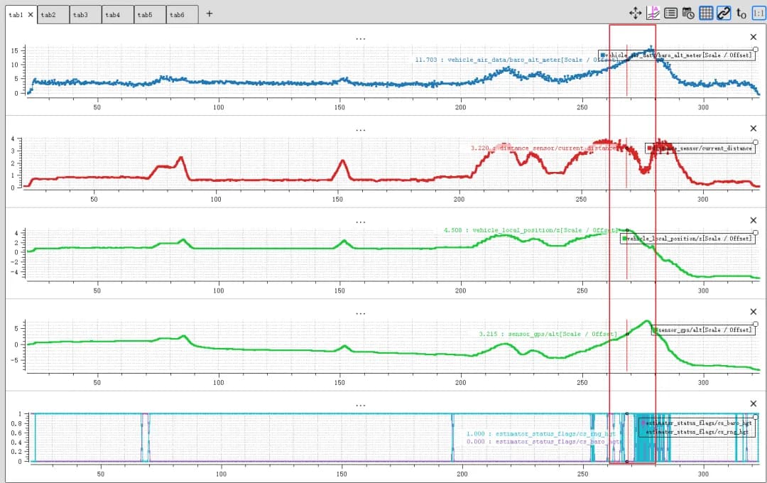

2. Altitude Anomaly Diagnosis
Log Analysis Findings:
Plot Data Source Observation
① Barometer Matched GPS altitude trend
② Rangefinder Output contradicted baro/GPS
③ Fused Height Erratic due to faulty rangefinder input
④ GPS Consistent with barometer
⑤ Altitude Source Flag Rapid switching between sources
Root Cause:
  • EKF2_RNG_AID parameter enabled fusion of rangefinder data (which was faulty).
  • The EKF2 estimator oscillated between baro (correct) and rangefinder (erroneous), causing altitude divergence.
Solution:
Disable rangefinder aiding (EKF2_RNG_AID=0) or recalibrate the sensor.
