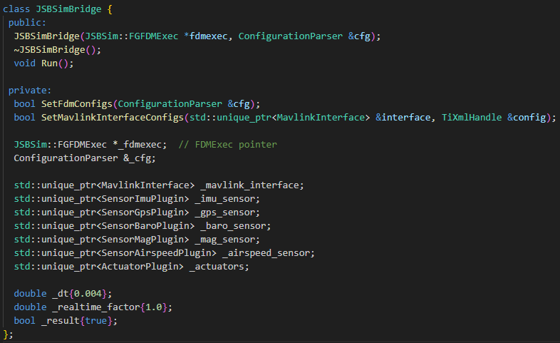

PX4-Autopilot-1.14.3\Tools\simulation\jsbsim\jsbsim_bridge\include\jsbsim_bridge.h
in line 83.
I want to run the JSBSim faster than 250 Hz because of the accuracy.
So, I tried to change the _dt value from 0.004 to 0.001.
Buy, It made the poll timeout (0, 22) error during SITL simulation.
How Can I increase the time step for SITL with JSBSim???

Increasing the timestep does not necessarily increase the “accuracy” of the simulation. It just increases the resolution of the dynamics.
I am not sure why you have a problem of adjusting the timestep. Are you sure that the jsbsim_bridge is still running after the poll error?
I would check: px4-jsbsim-bridge/src/jsbsim_bridge.cpp at 68de2cc63ded9a0d6641d45e9eb3ed2b43454cba · PX4/px4-jsbsim-bridge · GitHub
