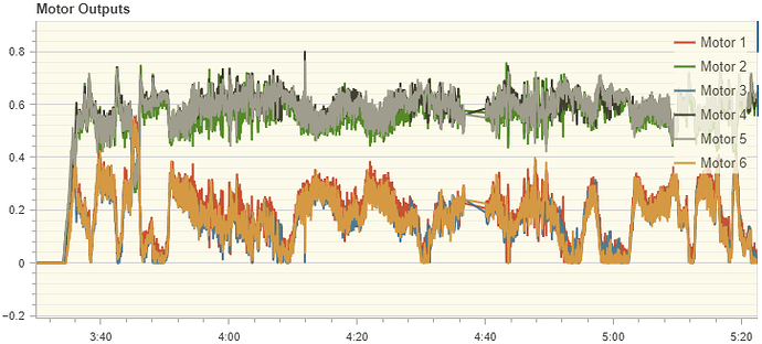

Hi, I build a hexacopter on CubeOrange, with T-Motors MN601-S and 20-inch propellers. During the flight, I noticed that CCW motors are sometimes spinning on the minimum. As I reviewed the log, CW motors are working on around 60%, while CCWs are chilling on about 20%. What can be the cause of such behavior?
I checked for mechanical imbalance, but everything seems to be fine.
I haven’t finished PID tuning yet, because I want to fix this issue first. Currently drone is flying pretty ok, except for very slow YAW turning (probably because of imbalance).
Log file: https://review.px4.io/plot_app?log=cb1ee847-d367-4bfb-bd8d-1df4650f64a6

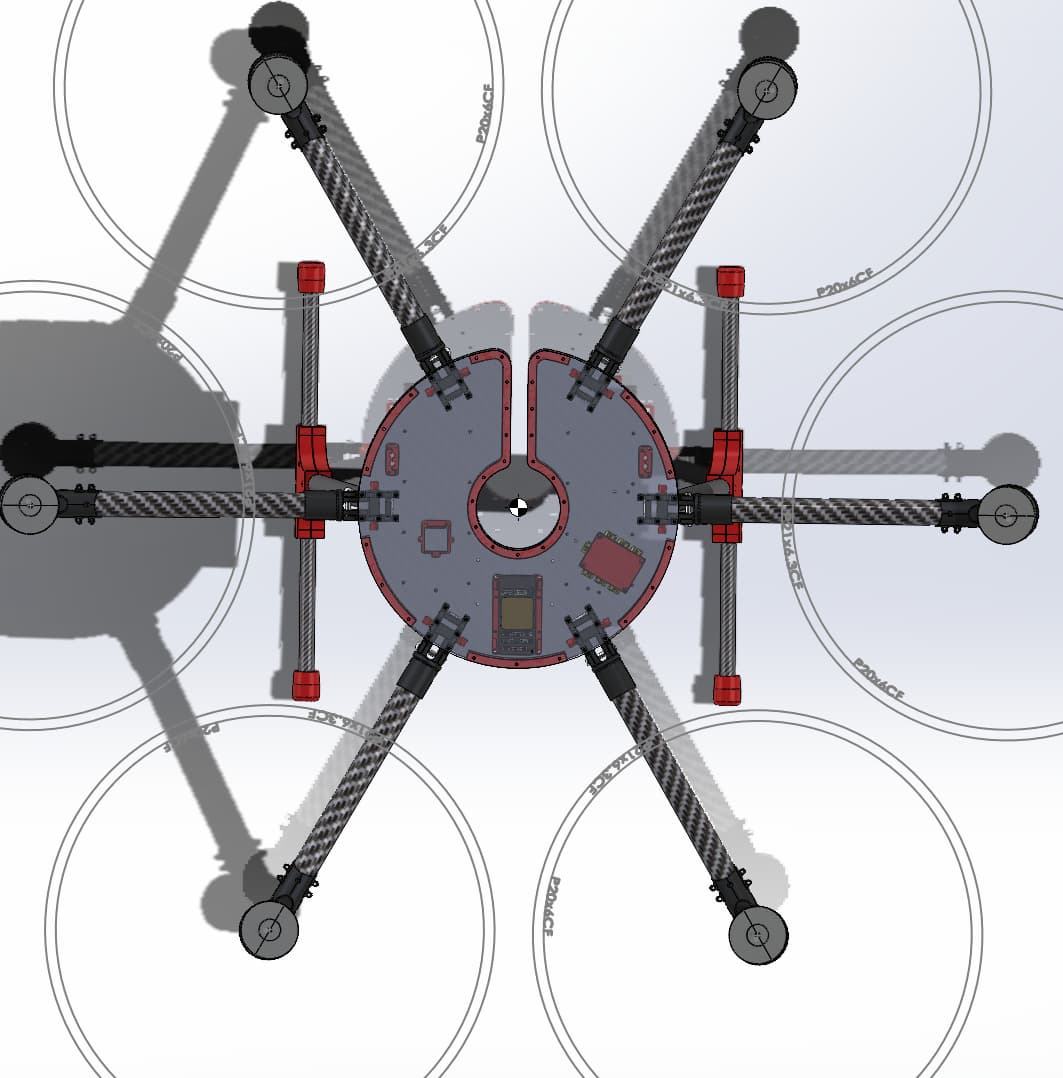

Motors placement and directions (ignore arrows):
hexa_motors_directions
Any help would be greatly appreciated :slight_smile:

Are your carbon tubes square or round? If your tubes are round, how do you control rotation of the motors around the carbon tubes?
This behavior could be observed in situation when one or more of the motors have a tilt around the mounting CF tube, resulting in a yaw rotating force. This force needs to be compensated by differential thrust on CW/CCW motors.

Think the other way round, aerodynamically:
If the motor axes were all parallel,
CW motors working 60% and CCW 20%
should make the whole craft spin CCW like crazy.
So you must have mounted the majority of the motors in a corkscrew fashion.
Center of Gravity has nothing to do with it. Nor has any software or firmware version.
CW motors working 60% and CCW 20% should make the whole craft spin CCW like crazy.
Well actually mine is slightly turning CCW when CCW motors are 70% and CW motors are less than 50 %.

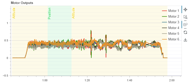

Finally, I managed to find that motor 4 was slightly tilted to the left (about 0.5-1.0 degrees).
Here is the plot of the motors after fixing the problem:
Thank you all for your help!
