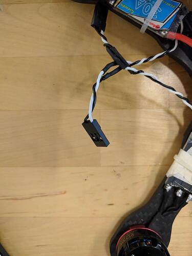

Hello all.
The pixhawk mini autopilot comes with a PWM breakout cable. While each individual cable does connect to my ESCs just fine 7 on 8 have only one wire and hence only one pin… And the 8th has all {+ve -ve and signal I’m assuminng?}. So how exactly can I use this because with my frame I prefer not to use the included PWM header.
Thank you all in advance!
I’d make sure that each esc has a gnd and signal wire connected.
The connector with 3 wires is Gnd (black ),+5V (Red),Signal (White).
If you are building a quad then you will only need 4 outputs.
I’d make my own wiring for it.
