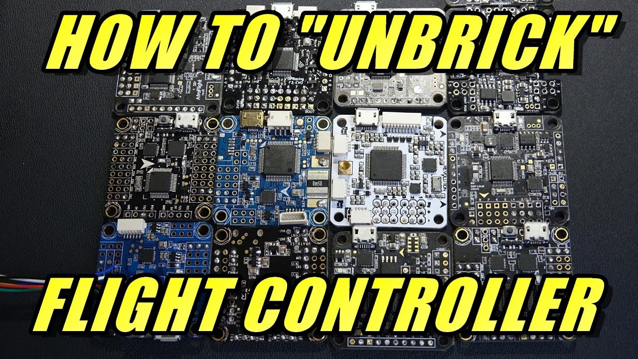

Ended up having to use a ST LINK to wipe the FC clean.
Great tutorial if anyone needs
