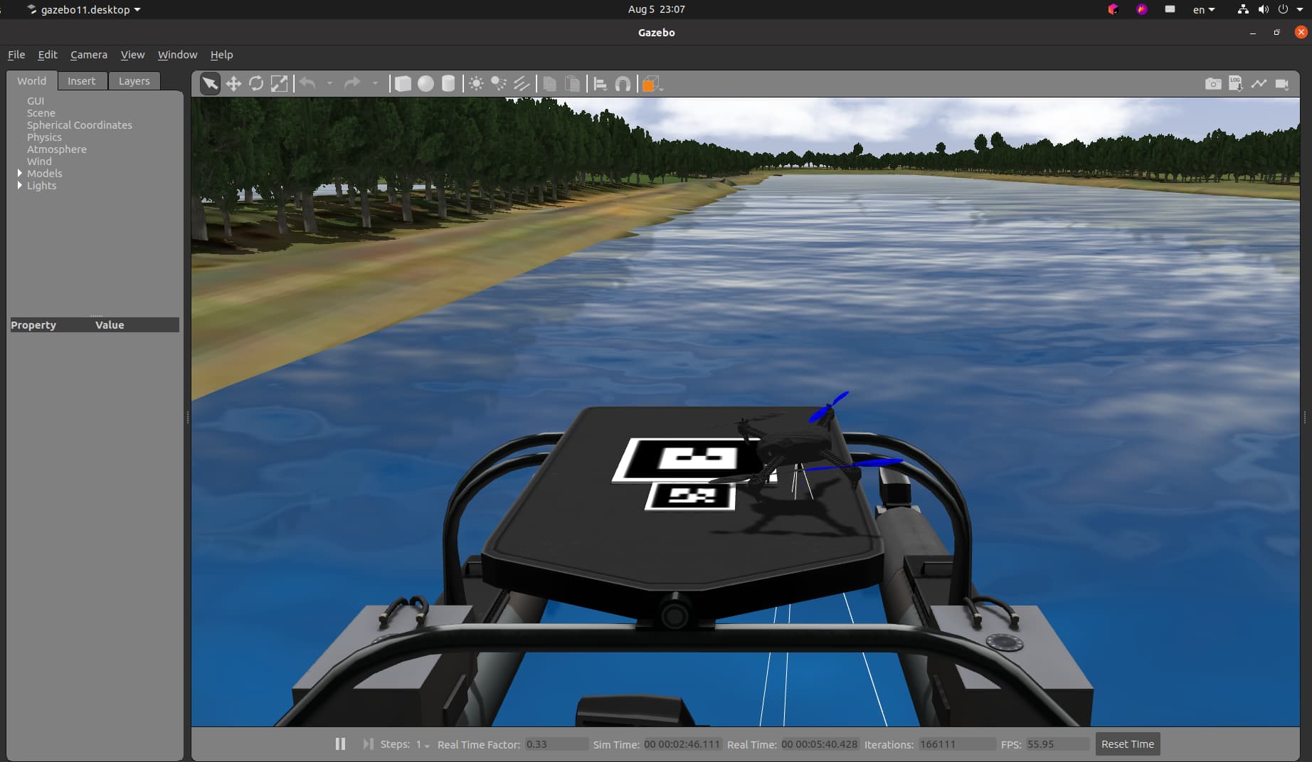

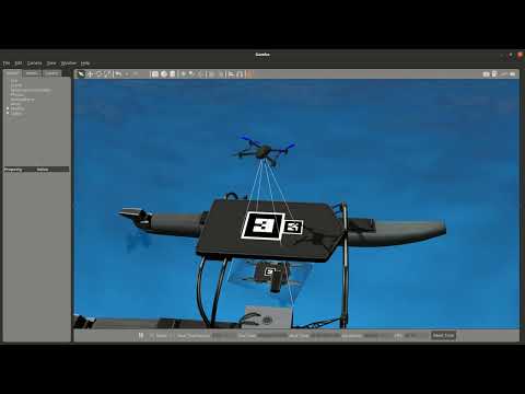

How to disarm drone in the offboard control

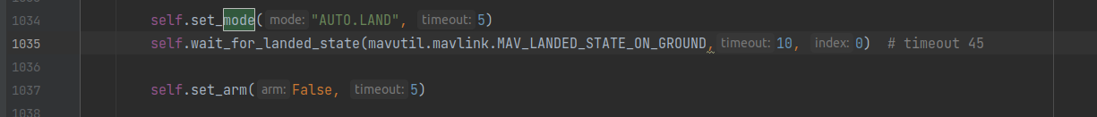

Could I disarm the drone without this two lines?

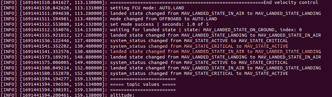

Because the drone cannot stop motor immediately and the boat will move away.

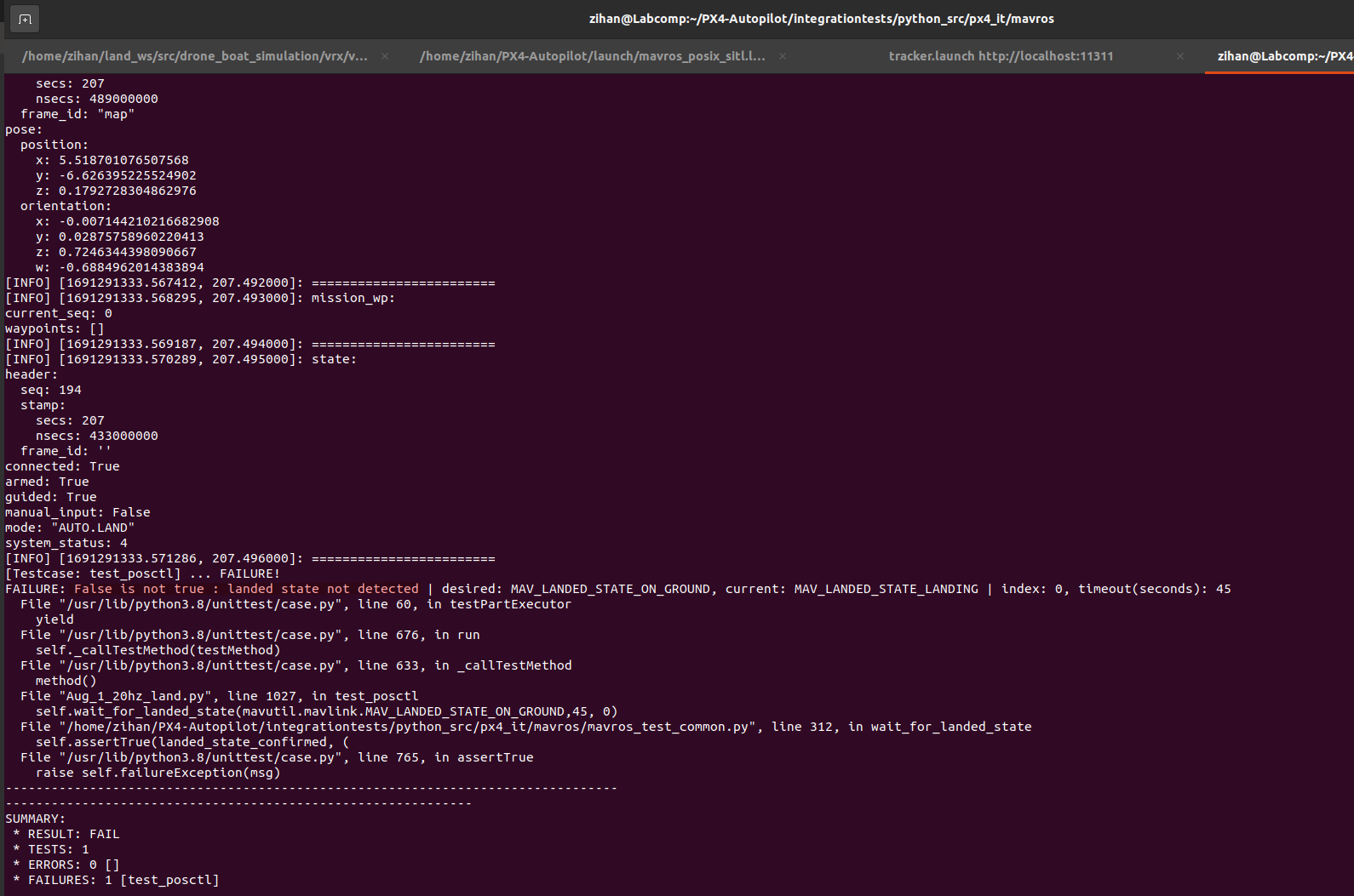

self.set_mode("AUTO.LAND", 5)
self.wait_for_landed_state(mavutil.mavlink.MAV_LANDED_STATE_ON_GROUND,10, 0)
FAILURE: False is not true : landed state not detected | desired: MAV_LANDED_STATE_ON_GROUND, current: MAV_LANDED_STATE_LANDING

I follow the instruction and changed the parameter CBRK_FLIGHTTERM from 121212 to 0.
however, the landed state just changed repeatedly from MAV_LANDED_STATE_LANDING to MAV_LANDED_STATE_IN_AIR

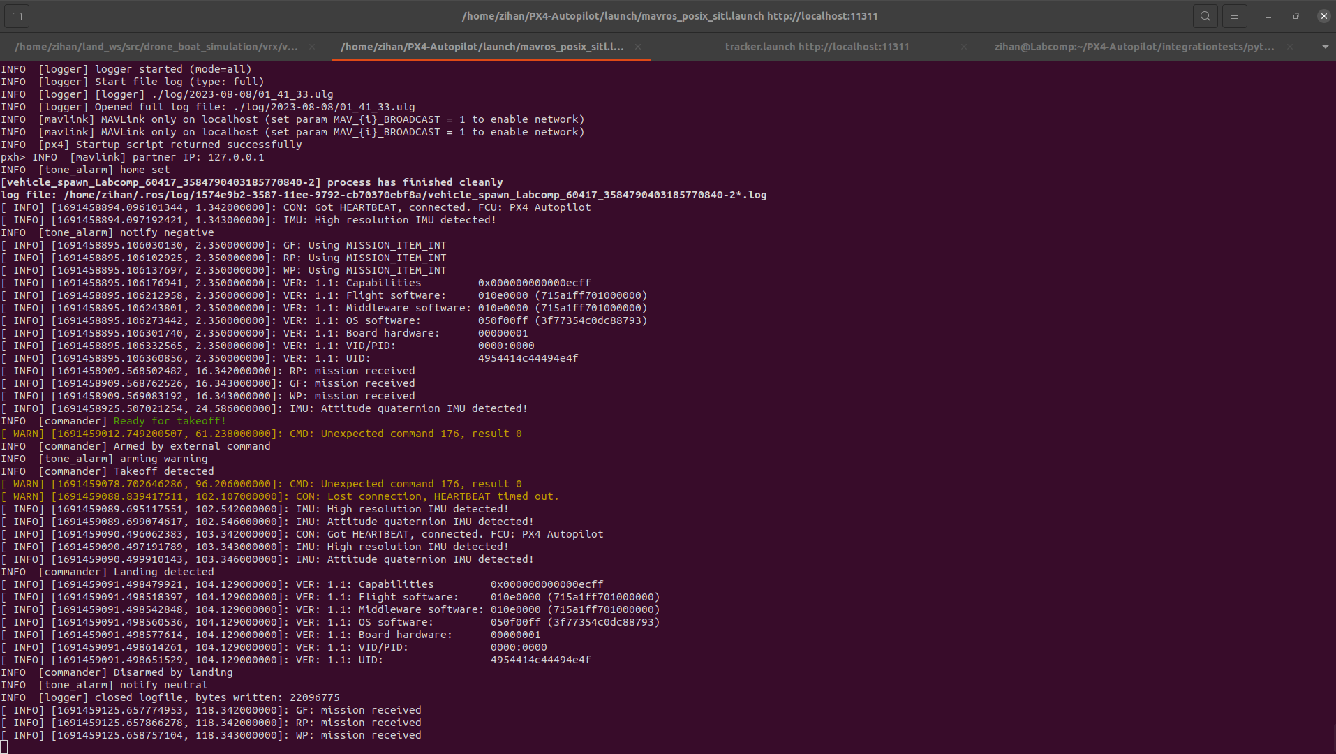

Landing on the solid place is ok. The messages like the below
armed state changed from True to False
connected changed from True to False
mode changed from AUTO.LAND to
system_status changed from MAV_STATE_ACTIVE to MAV_STATE_UNINIT

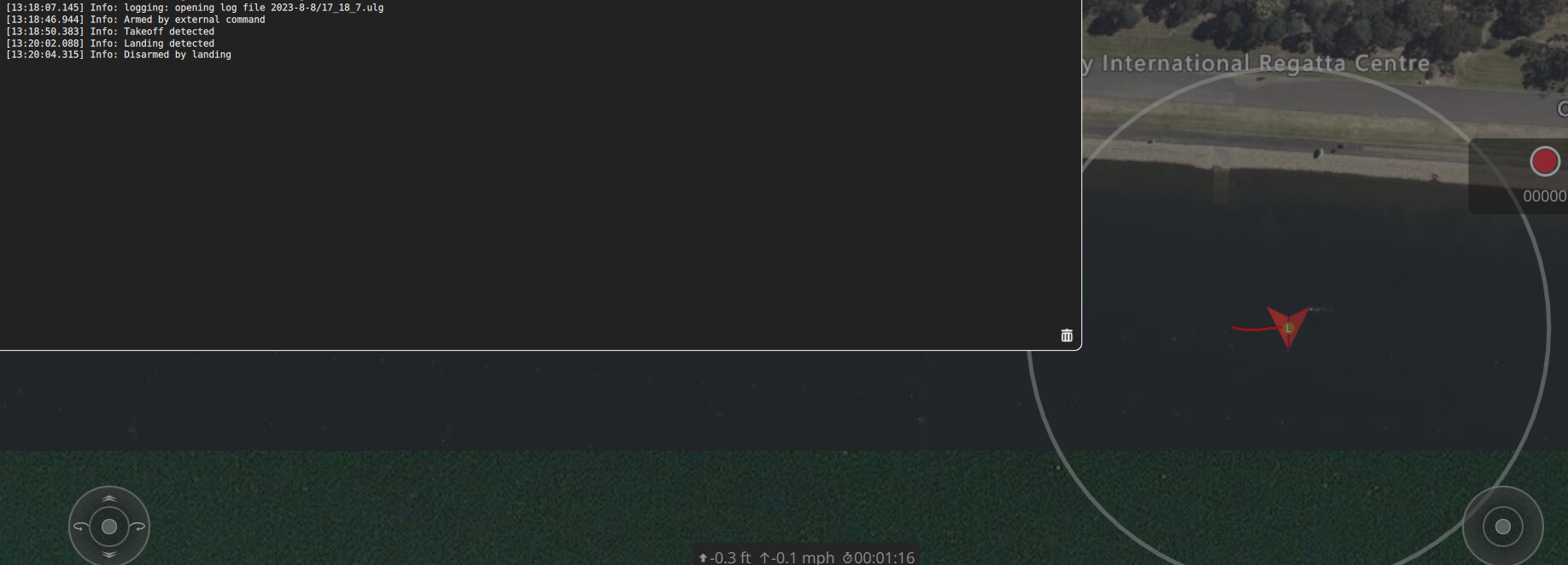

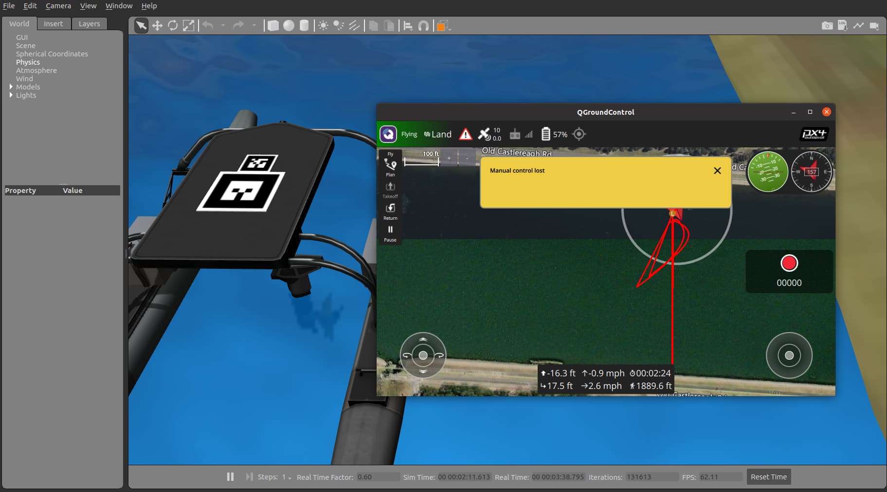

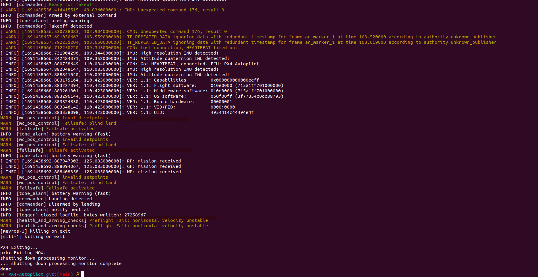

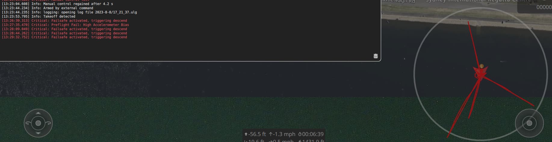

However, landing on a boat cannot work. The messages like the below:
WARN  [mc_pos_control] invalid setpoints
WARN  [mc_pos_control] Failsafe: blind land
WARN  [failsafe] Failsafe activated
ref: Can’t start sitl sim “warn [mc_pos_control] invalid setpoints”

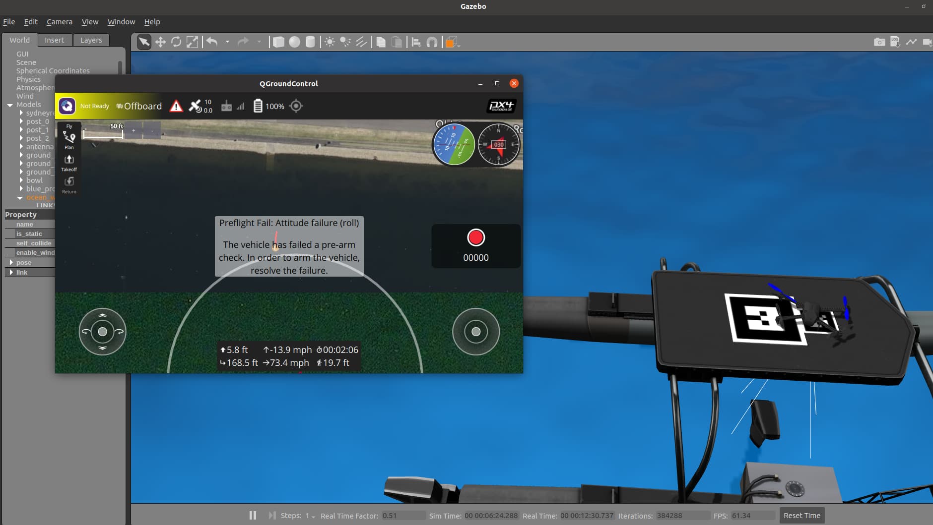

The drone’s rotor keeps spinning. probably due to the different altitudes.
The GPS becomes noisy
I am not whether it is a good way.

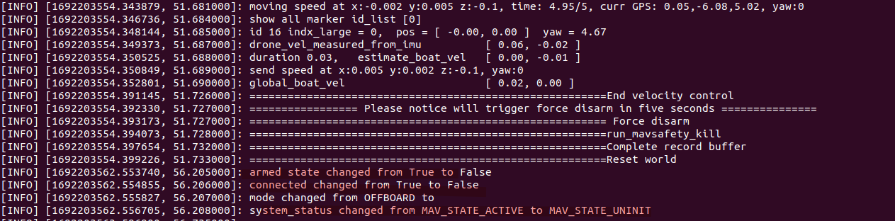

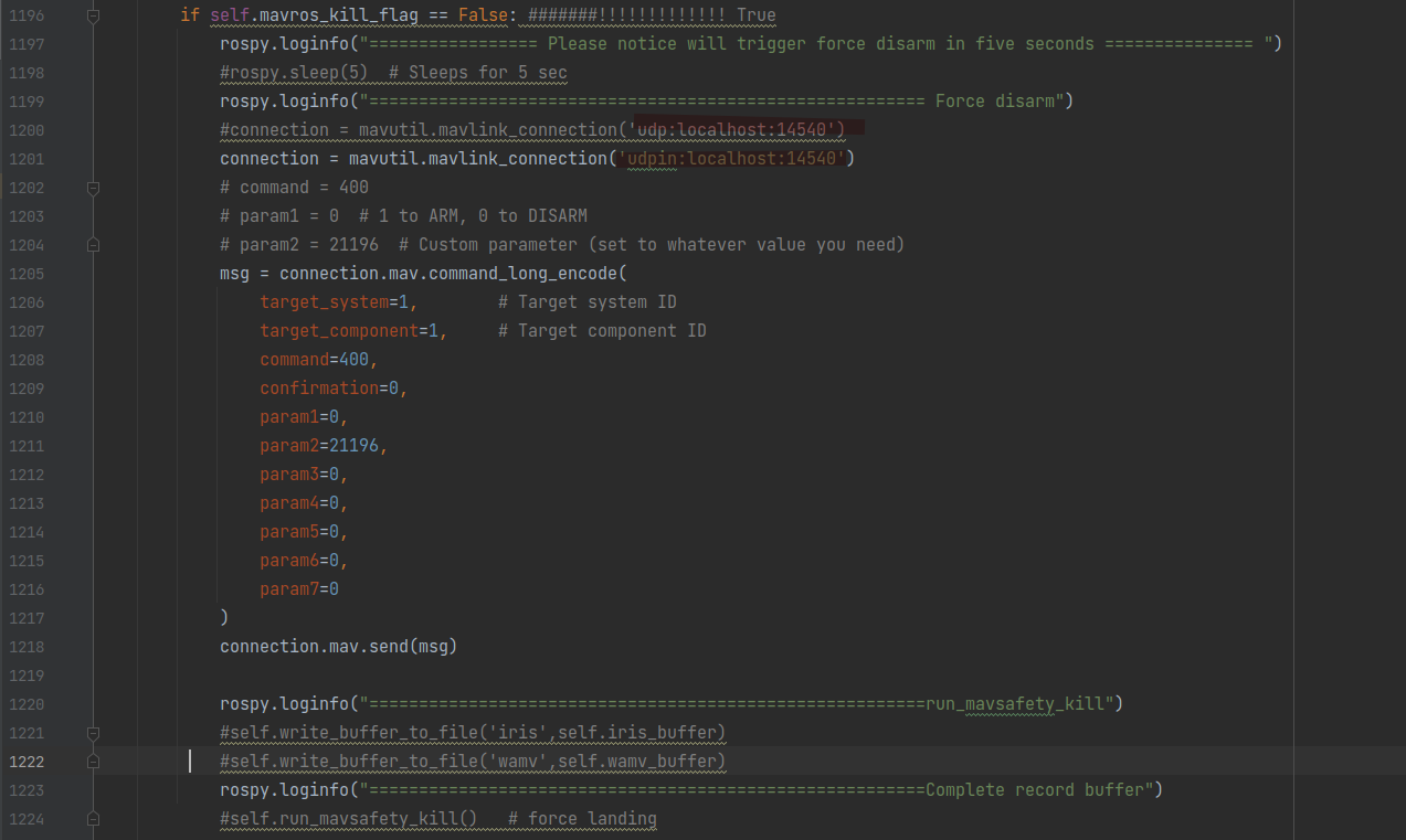

My temporary solution is using
rosrun mavros mavsafety kill according to this post. (mavsafety kill feature for emergency stop)
    def run_mavsafety_kill(self):
        try:
            # Run the 'rosrun' command with 'mavros' package and 'mavsafety kill' arguments
            subprocess.run(['rosrun', 'mavros', 'mavsafety', 'kill'], check=True)
        except subprocess.CalledProcessError as e:
            rospy.loginfo("Error running command:", e)
        rospy.loginfo("Force disarm")
        connection = mavutil.mavlink_connection('udp:localhost:14540')
        # command = 400
        # param1 = 0  # 1 to ARM, 0 to DISARM
        # param2 = 21196  # Custom parameter (set to whatever value you need)
        msg = connection.mav.command_long_encode(
            target_system=1,        # Target system ID
            target_component=1,     # Target component ID
            command=400,
            confirmation=0,
            param1=0,
            param2=21196,
            param3=0,
            param4=0,
            param5=0,
            param6=0,
            param7=0
        connection.mav.send(msg)
        rospy.loginfo("run_mavsafety_kill")
        self.run_mavsafety_kill()
The GPS is still drifting.
mode changed from OFFBOARD to
