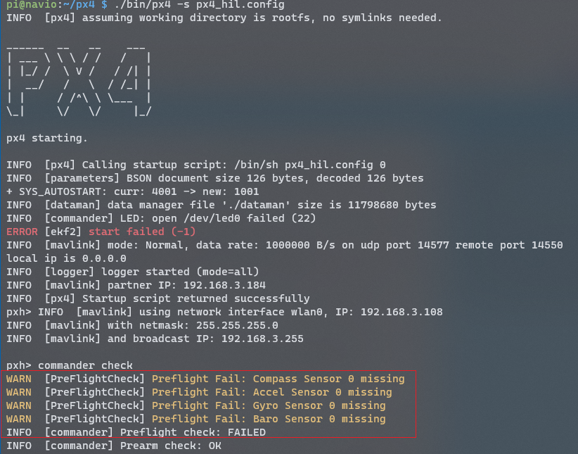

I’m trying to make PilotPi work with HITL(using jmavsim as simulator). I’m doing as the following steps.
  1. compile px4 for raspi. PilotPi
  2. start jmavsim and set correct udp port for mavlink.(udp 14550 for receiving PilotPi mavlink message)
# The following is part of Tools/jmavsim_run.sh
java -XX:GCTimeRatio=20 -Djava.ext.dirs= -jar jmavsim_run.jar -udp 14550 $extra_args -qgc 192.168.3.165:14550
  1. use px4_hil.confg as startup script to start px4 on raspi. PX4-Autopilot/px4_hil.config at master · PX4/PX4-Autopilot (github.com)
    pi@navio:~/px4 $ ./bin/px4 -s px4_hil.config
  2. jmavsim showed that it received mavlink message from raspi. However, px4 running on raspi got no sensor data and ekf2 failed to start.
Anybody knows How can I run HITL simulation for Pilot Pi(or navio2)? many thanks.
Hi @january147 , I’m also trying to run HITL, but on BeagleBoneBlue. There’s no px4_hitl.config for BBB so I’m trying to adapt the one for Pi. What I found and it might help you is that actual flag should be -h not -hil according to doc (System · PX4 Developer Guide)
Please try to change to:
sensors start -h
commander start -h
When I changed this I’m not receiving Preflight Fails, but still I don’t see the sensors messages. I wonder if it’s my wrong connection setting or something else?
Please let me know if that helps.

I’ve used your jmavsim -udp 14550 setting and now I see sensor topics!
Thanks, it works using “-h” instead of “-hil”. PX4 runing on rpi now received sensor data from jmavsim. However, The drone still won’t take off.

I managed to fly the drone in HITL mode using jmavsim. There are some errors in the px4_hil.config file. See the correct modified file below. I will list the modifications:
  1. sensors start -h
  2. commander start -h
  3. comment out ekf2
  4. pwm_out_sim start -m hil
Then launch using the following command -
sudo ./bin/px4 -s px4_hil.config
after that in the px4 terminal start ekf2
pxh > ekf2 start
Then using Qgroundcontrol ARM the drone.
