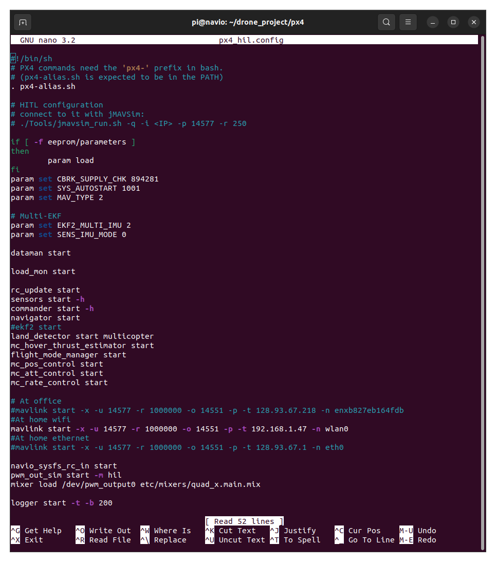

PilotPi: Raspberry Pi HITL does not start ekf2
  1. First, I followed the instructions in “https://discuss.px4.io/t/hitl-for-pilot-pi/25776” to change sensors start -hil to sensors start -h, and commander start -hil to commander start -h;
  2. I used the raspberryPi with . /px4 -s px4_hil.config to start the flight control;
  3. I found the flight control stuck at ekf2 start not starting.
    What causes this and how can I start HITL on RaspberryPi?

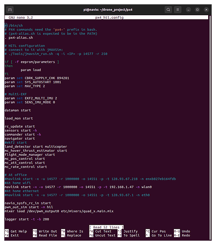

Here are the Images associated to this problem…
I managed to fly the drone in HITL mode using jmavsim. There are some errors in the px4_hil.config file. See the correct modified file below. I will list the modifications:
sensors start -h
commander start -h
comment out ekf2
pwm_out_sim start -m hil
Then launch using the following command -
sudo ./bin/px4 -s px4_hil.config
after that in the px4 terminal start ekf2
pxh > ekf2 start
Then using Qgroundcontrol ARM the drone.
