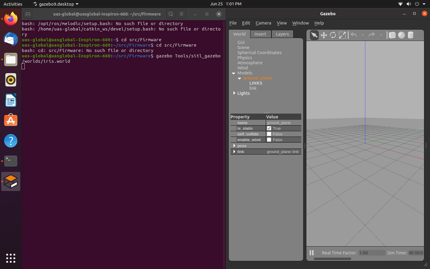

@JulianOes I am suffering from the same problem. I followed all the process mentioned in this link: HITL Simulation · PX4 Developer Guide and as soon as my HITL starts running, nothing shows up. There are no vehicle in Gazebo and no connection. Attached is the image of what I am getting.
When following the docs make sure to look at the correct version. @mehdi786 you posted the link for v1.9. (I’m not sure if that’s the reason, but just saying.)
Is the airframe and SYS_HITL param set correctly?
