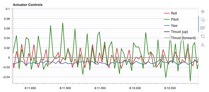

Hey all,
I dropped off this thread for a while because I moved over to Arducopter which didn’t have this vibration issue but I’m now back because I’ve built out a new system and need to use PX4 (V1.14). I just did some test flights with my news drone and I’m currently using the default tuning parameters for IMU_GYRO_CUTOFF (40 Hz) and IMU_DGYRO_CUTOFF (30Hz). My vibration levels looked high again on this new vehicle (Cube Orange+ hard mounted) so I turned on high rate logging and did a short flight. Logs below.
I have some peaks in the Actuator FFT and Ang Vel. FFT about the cutoffs. Everything on this vehicle is really tightly held down and nothing is loose. I do have long landing gear (0.5 m) that I think might bee the cause of the FFT peaks right below 20 Hz. I need those long gear for my payload. My first flight that showed high accel didn’t have that gear attached though, so I know my high level of vibe reported isn’t from the landing gear.
The vehicle seems to be flying okay, although I’ve notice a little shimmy/wiggle sometimes after or during control inputs. Seems like a lightly damped oscillation. Should I drop the cutoff freqs down as was suggested before? My drone is about 4.3 kg, so fairly large.
Any idea what is going on with those control FFT peaks and the ang vel FFT peaks? Could that be the propeller wash over the arms since there is a second peak at 2X the first peak? Should I be concerned by any of this?
Thanks,
Michael
https://logs.px4.io/plot_app?log=fb966060-ebf9-49ed-b29b-d27da9b866ae
Could this frequency be the blade pass frequency of your props?
Or could this be a control issue with P and/or D gains too high?
I don’t know how to determine if this is a control issue or the blade pass frequency. I am seeing the same oscillating rates in yaw and roll (see below) and in the roll, and pitch actuator controls. Is there a way to determine if the vibration is causing the flight controller to fluctuate the actuator input or the other way around?
Of these plots, it seems like the pitch oscillations are the largest.
