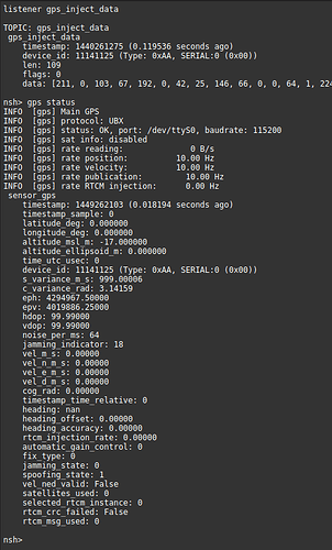

The RTCM data is received by the Pixhawk and forwarded to the simpleRTK which I can see by connecting to the simpleRTK via u-center, however the data can`t be parsed and is labeled as unknown.
ucenter-unknown
Now it could be that I somehow misconfigured the simpleRTK board, but to find that out I was trying to follow the RTCM data and see if it gets mixed up somewhere.
My first step was to look at the gps_inject_data message using QGroundControl`s MAVLink Console. When viewing the data there, I was not able to find any relation between the data I sent to the PixHawk and the data printed out there.
The data i sent started with 211, 0, … and I found no match somewhere in the array.
Now my question is if I am parsing the data correctly and if the way I check the data is even correct. I would also be interested what the “flags” parameter in the message means exactly as this was the only thing changing at some times.

This problem seems to persist. I send the correct RTCM data (as string, as it is suggested here
Data I send start with [211, 0, 123, 67, …
Data I observe at the mavlink console with
nsh> listener gps_inject_data
appear somehow random and hence the the gps fix_type remains at 3 and never reaches 6. With QGroundControl in contrast, it works perfectly.

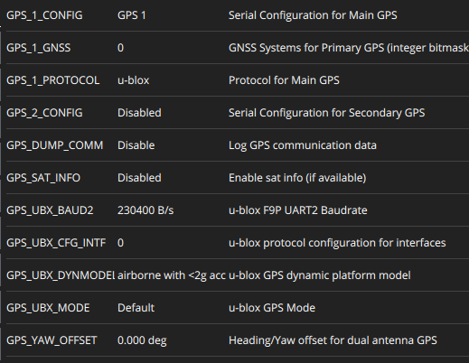

Hello @JulianOes!! I have a similar problem. I’m trying to inject RTCM corrections to Holybro F9P from Pixhawk, that is receiving them by ROS2 and UXRCE agent-client via TELEM2 port (ROS2 in running on a Jetson). Currently, I can see gps_inject_data as uorb topics in px4 shell (listener gps_inject_data) and they seem valid, but inspecting gps status show that no RCTM correction are received. So I guess the corrections are entering the PX4 environment but are not forwarded to the GPS module.
I configured GPS_1_CONFIG to GPS1 (where F9P is connected), SER_GPS1_BAUD is Auto (but 115200 has the same result), GPS_UBX_MODE is Default. In u-center I configure UART1 port of F9P with: Protocol in=UBX+NMEA+RTCM3, Protocol out=UBX, Baudrate = 115200.

I can’t really understand what I’m doing wrong, also I’ve tried with different parameters and also using TELEM1 (Pixhawk side) and UART2 (F9P side) to connect the GPS module, but still no luck.

What PX4 version is this? And maybe you can share a log of it?
Thanks for your reply! I’m using PX4 1.15.
Looking at the gps.cpp was a great hint. The issue was that i was sending the correction messages using the device_id of the GPS, but then i found out these line of the gps.cpp:
// Prevent injection of data from self
			if (msg.device_id != get_device_id()) {
				/* Write the message to the gps device. Note that the message could be fragmented.
				* But as we don't write anywhere else to the device during operation, we don't
				* need to assemble the message first.
				injectData(msg.data, msg.len);
				++_last_rate_rtcm_injection_count;
				_last_rtcm_injection_time = hrt_absolute_time();
and I understood. Thanks for your time, hope this help someone else!
Aha, so what device ID did you have to use? I wasn’t aware of this.
