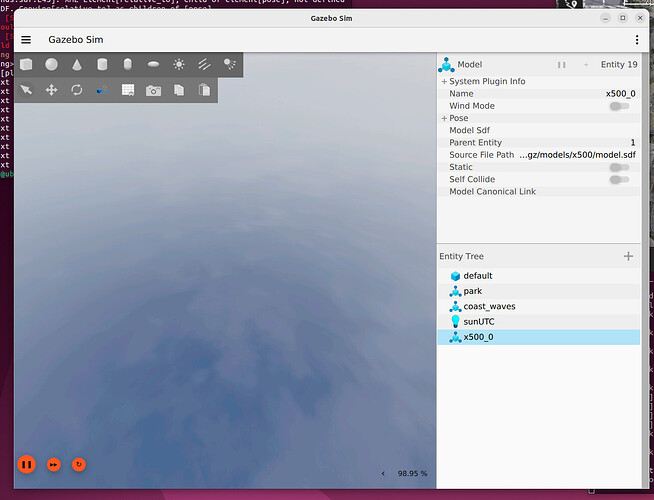

Gazebo entities not rendered
Anyone ever have a problem like this before?
I’m running make px4_sitl gz_x500_baylands and it seems like everything is working other than the drone and the park are not actually rendered.
I’ve tried both the v1.15.4 tag and the current main branch and both have the same result.
Running on a brand new Ubuntu 22.04 install in VMWare Workstation.
The baylands world can take a while to load. Does it work with the default world? Can you share the output from the startup?
The default world is similar. The drone doesn’t render.
Nothing jumps out at me in the console output.

I can still fly the drone and crash into trees and stuff, so I’m pretty sure that the files actually loaded correctly. I just can’t see anything.
Can you enable gz debugging?
export GZ_VERBOSE=4
I think running in a VM isn’t well tested
Had to use a pastebin for the verbose output because it exceeds the 32k character limit of this forum.
The “No camera …” keeps repeating forever at the end.
Hmmm nothing obvious jumps out at me. It does look like the sim starts successfully.
