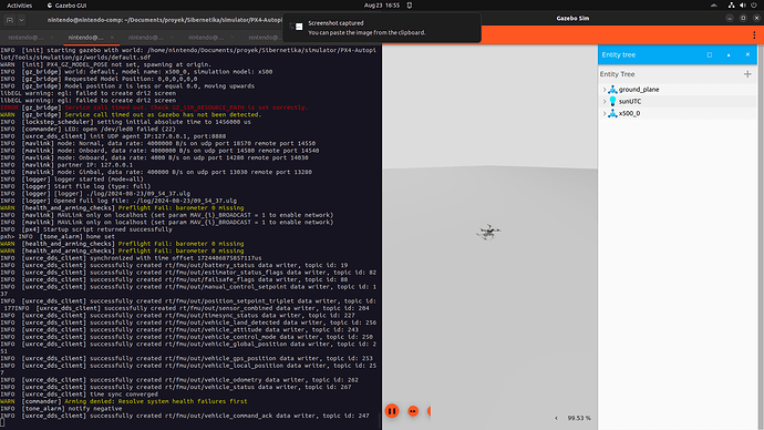

Hi All, I’m new here. I have been following the docs for simulating the x500 and controlling it through uxrce dds, now i can receive datas and run the gazebo simulation but can’t arm the drone using the recommended git repo px4_ros_com. It says
Arming denied: Resolve system health failures first
I even try to open QGroundControl and only found that i need to calibrate accelerometer and there is no barometer input. I’m confused how to proceed with that error since it’s simulation…
Here is some pic
Thanks!

I was also get confused when i opened the QGC since it reports more errors
I have checked the model.sdf of the x500 and confirmed that the sensor description is already included. But I suspect the model that i refer to is not actually what i use on the gazebo since the name on the log is a bit different (it’s x500_0 instead of just x500)
The model.sdf that i thought i use: PX4-gazebo-models/models/x500/model.sdf at 536305adee09b9ace391b16107e625cf7c6db7e7 · PX4/PX4-gazebo-models · GitHub
Initial log that i received:

pxh> WARN  [health_and_arming_checks] Preflight Fail: barometer 0 missing
WARN  [health_and_arming_checks] Preflight Fail: Compass Sensor 0 missing

I’m not changing anything and suddenly it works. Weird though
Only thing that i tried was exiting and restarting the gazebo
