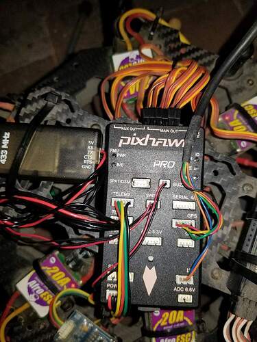

I am new to Pixhawk and drones. When exploring the Hexacopter I purchased (Tarot chassis + Pixhawk Pro set), QGC was not connecting and requiring a firmware update. I did, and it was a mistake, because it is now really impossible to connect. The symptoms are clear :
If I flash the PX4 version, I can connect, but the big led is flashing red, and configuration is not saved.

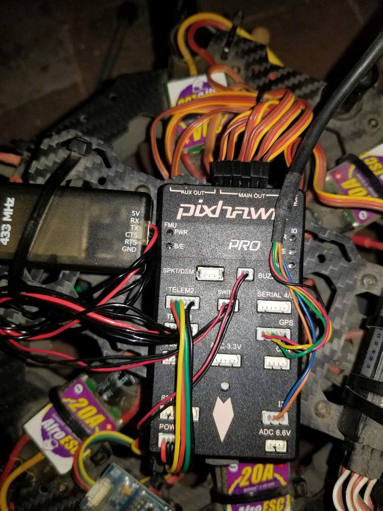

I am sure it is a chinese clone, because of the printing on the box, the form of the big arrow is typical. It is mentioned : Pixhawk Pro and on the side : PX4
We have verified : the RAMTRON chip is present on the card.

Wild dude, any chance you can attach a pic of this A/P? Or is it essentially identical to the Pixhawk 4 on the outside?
There was another issue : for some reason the bootloader was limited to 1M, although there is 2M available. This was limiting to the v2 which has a lot of restrictions. Upgrading the bootloader and installing the fmuv3 version was a great progress.
