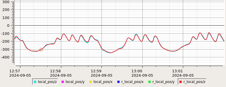

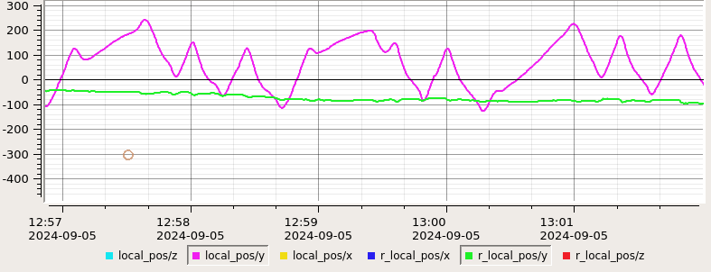

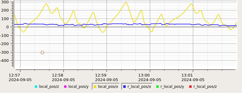

Here is an example of the local position comparison from the actual flight vs the replay (prefixed with r_), the altitude (z) seems to be reproduced mostly correctly, the xy position not:
What could cause this difference? What could we be doing wrong in the replay setup that we don’t get the same results when we supply the same parameters?
