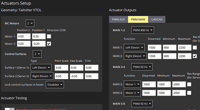

Now starting with the setup,
I have started something as in the above image and for the sensors calibration, I have kept the front direction of FC parallel to the nose of the bird while calibration I got to know that it should be done as for the multi-copter. So for this I have to change the orientation of the FC to pitch 90(right?). What about the GPS and the compass in it then?

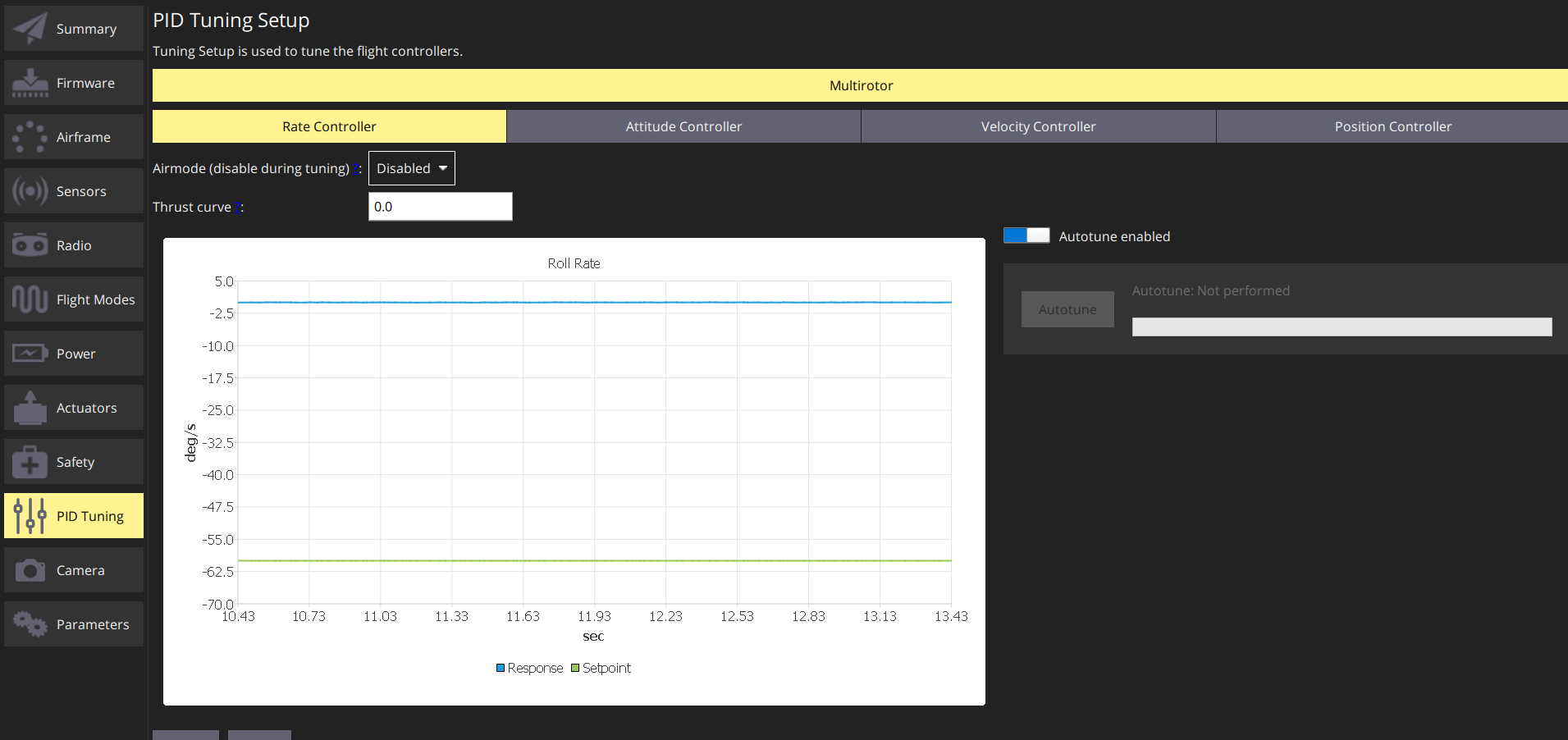

Now to start with the VTOL tuning I use this page,
Which one should i start with from the basic to advance.
If this is for just the VTOL, where and how to complete fixed wing tuning?
Once this VTOL and FW tunings are done, I suppose for the transition there are direct parameters and I have to check with them. How do i validate the transition is correct or wrong (apart from flying with the logs?) and how to make it better?

I got another question
where the motor position X and motor positon y, is it from the CG of the aircraft or from the FC?

From the CG, see Actuator Configuration and Testing | PX4 Guide (main)

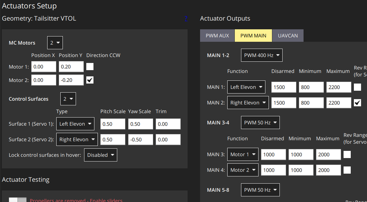

I am facing a issue with my bird, where soon as armed and throttle rises bird just rolls 360degrees.
Calibrated Accel, compass and level horizon before every flight, but still the same.
ESC’s are calibrated multiple times aswell.
Above 2 log are the ones where I have faced these issue.
Resposes are much appriciated!
