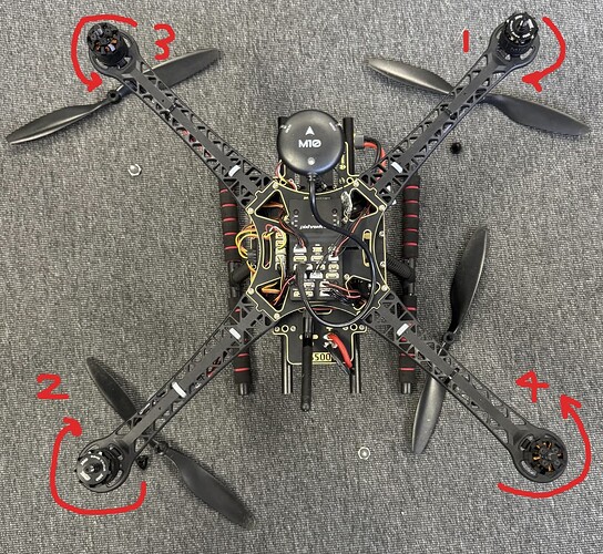

I have a Holybro S500 frame that I have mounted
  • Emax MT2216 II 810KV motors
  • Emax Bullet 35A ESC
  • 6S1P Li-ion battery (4200mAh, 45A peak)
  • Pixhawk 6C with M10 GPS
  • 1045 propellers

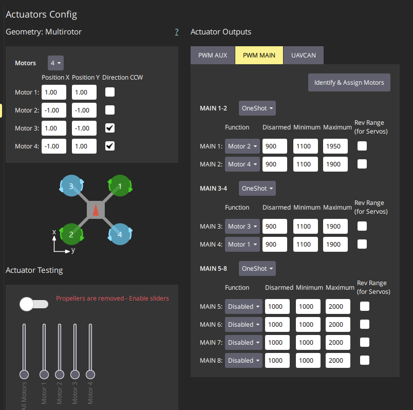

My problem is that whenever I am trying to take off (Stabilized or Altitude mode), the drone just flips/rolls over to the right side each time.
I have calibrated all sensors a few times, I have checked the motors spin and orientation a few times, but it still happens.
I am checking roll / pitch / yaw orientation using the QGroundControl artifical horizon which responds as I expect
The motors are configured and spins as the labeling says

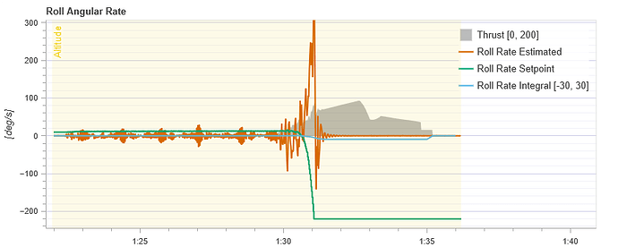

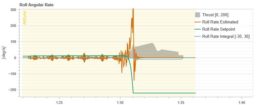

But it still seems like it is rolling to the wrong side during take off - If I check the log file, I can see the setpoint and estimate are going opposite ways.
So - Motors are spinning as I expect (In Acro, the motor also tilts as I expect with the joystick), sensors are calibrated, no warnings.
Is there anyone who has a suggestion to what could be happening?
Log here:
Any help is appreciated.
I would definitely think it’s something to do with orientation of the Pixhawk or motor setup, as you suspected as well.
Also note that the max PWM for MAIN 1 is higher than MAIN2-4, probably an oversight.
I assume you have verified all motors and directions using the motor test tool?
And does the atificial horizon move correctly when you move the drone?
And have you tried arming without props and holding the frame to check if the correct motors speed up as you tilt it?
