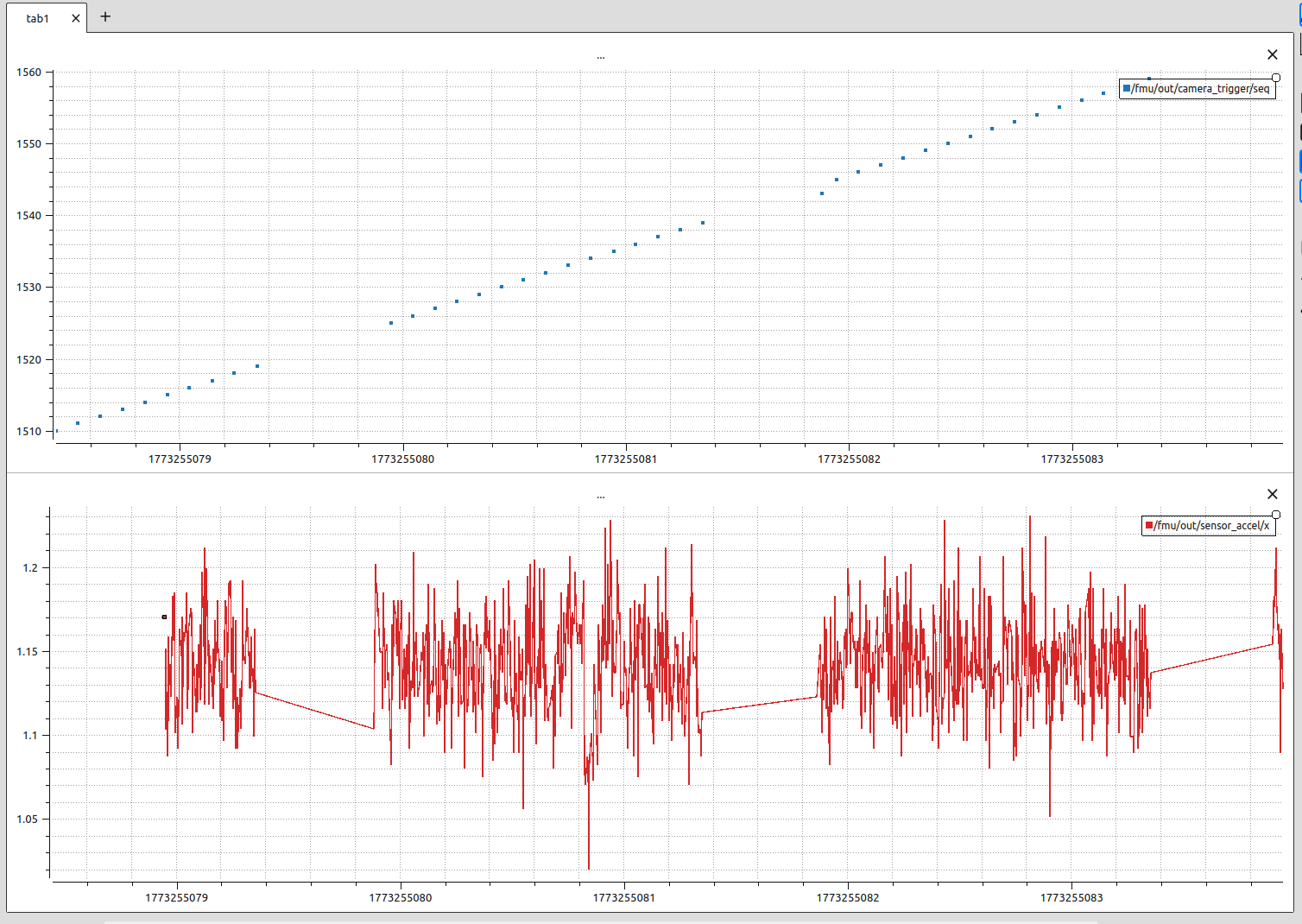

hi i have some problem with the dds
i have jump at the dds
NuttShell (NSH) NuttX-11.0.0

did someone have idea why i got this jump on the data ?
Those straight lines in the data are just that you are missing data and it is interpolating between the last 2 points. Get a good SD card and you’ll probably have less dropouts
Hi everyone,
I’ve been troubleshooting an issue where the uxrce_dds_client data flow would frequently lag or stop entirely. While some suggested a faster SD card, I found that the bottleneck was actually in the task scheduling.
I modified the task priority in src/modules/uxrce_dds_client/uxrce_dds_client.cpp to SCHED_PRIORITY_FAST_DRIVER, and now the data flow is fast and consistent without any interruptions.
Here is the code change I made:
C++
int UxrceddsClient::task_spawn(int argc, char *argv[])
    _task_id = px4_task_spawn_cmd("uxrce_dds_client",
                                  SCHED_DEFAULT,
                                  PX4_STACK_ADJUSTED(8000),
                                  (px4_main_t)&run_trampoline,
                                  (char *const *)argv);
    if (_task_id < 0) {
        _task_id = -1;
        return -errno;
    return 0;
This fixed my DDS problem immediately. I am sharing this in case it helps others, but I would also like to ask the experts: Is there a risk that setting the DDS client to such a high priority might interfere with other critical sensor drivers?
Thanks!
