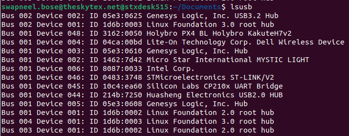

I’m able to build the firmware and flash it to my target device using STM32CubeProgrammer, however, the device is unresponsive. It is not detected as a USB device nor does QGC detect it.
How can I debug the acitivty and find out the root cause?

Hi Julian,
I have successfully built and flashed just the PX4 bootloader to address 0x08000000 on my custom STM32H743-based flight controller. Upon doing so, the device correctly enumerates as a USB CDC ACM device, confirming that the bootloader, USB interface, and initial hardware setup are functioning as expected.
However, after flashing the main PX4 application firmware to address 0x08020000, the device no longer appears as a USB device, and there is no output on the serial console (USART1 is configured for console output).
I have changed board.h to match my hardware pins and modified the clock section to accomodate my external 25Mhz oscillator.
