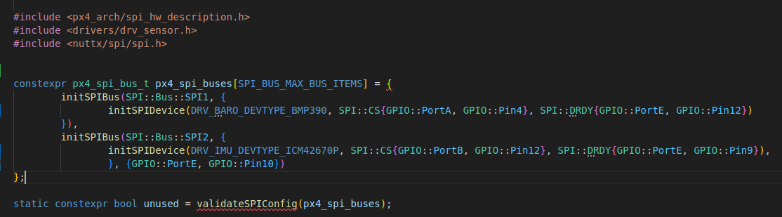

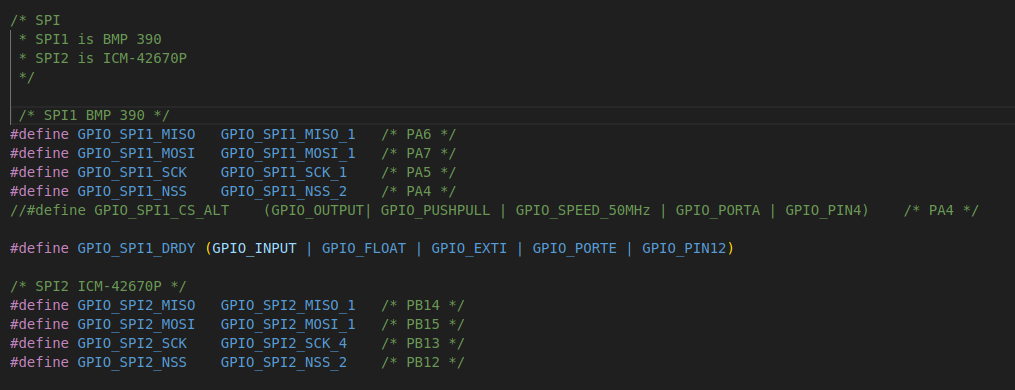

thanks for the reply. I have double checked my board.h and rc_board.sensors files and I can confirm that the pin mapping is correct. I’ve attached code snippets below for your reference.
board.h :
spi.cpp :

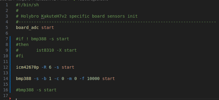

rc_board.sensors:
I have tried -c 0,1,2 for the bmp388 but no luck

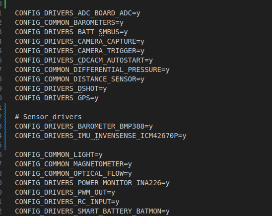

I’ve initialized the drivers correctly as shown :
Please advise me where else I can look, or if I’ve missed out a configuration elsewhere. Thanks in advance

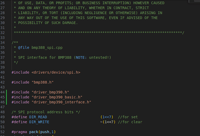

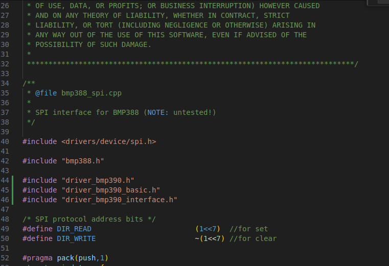

after doing some digging, tuns out the SPI driver for BMP388 is untested (as shown in the image below)
I will attempt at fixing this driver if needed, and will update any progress here

Yes, I identified several issues with the driver:
  1. The SPI read and write functions were unresponsive, as they did not quite follow the read/write process as followed by the BMP390 datasheet. I rewrote them such that they directly use the atomic SPI read/write functions and adhere to the BMP388/390 datasheet.
  2. I had to update the sensor initialization function in bmp388.c as I noticed the device wasn’t able to initialize correctly.
  3. Had to make minor tweaks to the soft_reset and compensation functions.
As of now, the device initializes correctly and I’m getting correct pressure readings, however the temperature readings are off by +10 to 15C. Still working on it, I shall record my updates on this thread!
