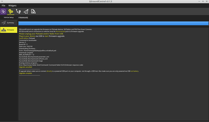

Thanks for the quick reply. My problem is about downloading firmware. I have opened an issue in the main page. I use STM32F427IIH6, but QGC always says erase failed. I cannot figure out what the problem is.

You have a older version of the STM32F427 chip (Revision Y). With this version of the silicon, you are unable to reliably access the second 1MB bank of the flash and use the USB at the same time. See more about this error here. Hence if you are using a revision Y silicon chip, you can only use the first 1MB of flash, hence why it your bootloader returns with the flash size being 1032192 bytes instead of 2080768 bytes.

@DoEon_Lee: You are compiling the bootloader for either the PX4_FMU_V2 target or the PX4_FMU_V4 target. If you add your own target to the bootloader makefile, this check on the silicone revision will not be performed. It is only performed for the V2 and V4 tragets (see code extract below):
