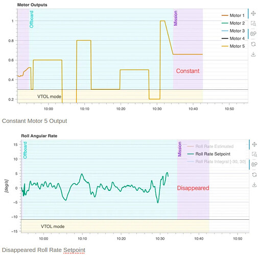

Crash phenomenon
We noticed irregular control commands after mode switch (Offboard → Mission):
Constant motor 5 output.
Disappeared roll rate setpoint.

Examine NaN values in raw data around mode switch (offboard → mission)
For the crash, we noticed irregular attitude & rates setpoint after mode switch in Flight Review. We attempted to look for NaN values in .csv files.
Noticed
NaNpitch setpoint invehicle_attitude_setpoint_0.csv. -

Combination of first three frame of tecs_status_0.csv after mode switch (Offboard → Mission)
In the table below, each row shows the first three frames of tecs_status_0.csv data immediately after the mode switch event. Some data fields show NaN all the time, but some data fields turn into NaN only in crashed flights.

Observation of Post-Mode-Switch Data
For these 2 flight logs, we looked into every uORB message log after mode switch, trying to find irregular NaN values.
vehicle_attitude_setpoint after mode switch
| Flight | q_d[0] NaN Rate | q_d[1] NaN Rate | q_d[2] NaN Rate | q_d[3] NaN Rate | pitch_body NaN Rate |
| 1(Normal) | <1% | <1% | <1% | <1% | <1% |
| 2(Crash) | 100% | 100% | 100% | 100% | 100% |
tecs_status after mode switch
| Flight | height_rate_direct NaN Rate | pitch_integ NaN Rate | pitch_sp_rad NaN Rate |
| 1(Normal) | 100% | 0% | 0% |
position_controller_status after mode switch
| Flight | nav_pitch NaN Rate | yaw_acceptance NaN Rate |
| 1(Normal) | 0% | 100% |
Observed Crash-Flight Anomalies
vehicle_attitude_setpoint: Crash flights show 84.6-100% NaN in q_d[0-3] and pitch_body -
tecs_status.pitch_integ: Crash flights show 98.4-100% NaN, normal flights show 0% -
tecs_status.pitch_sp_rad: Crash flights show 98.4-100% NaN, normal flights show 0% -
position_controller_status.nav_pitch: Crash flights show 96.3-100% NaN, normal flights show 0%
