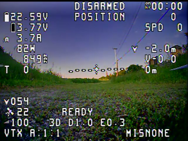

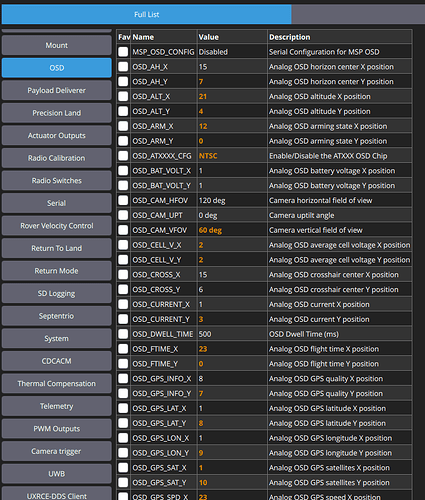

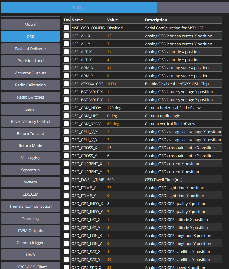

I am new to PX4 development but a part time contributor to other firmwares; in my learning of PX4 and applying PX4 to FPV-style architectures i saw that the built-in atxxxx driver had barely anything in it and had baked-in configurations that required a firmware build to change. I decided to tackle this on v1.17 on my MicoAir H743V2 board. After some struggling with issues due to bad SPI assignment; i managed to significantly improve and enrich it, adding a wide variety of elements that we expect from FPV-world firmwares; and making it fully QGC-configurable in bitmask activation and X/Y position.

  • OSD_STATUS: scrolling PX4 log messages and fallback vehicle status text
  • OSD_LOG_LEVEL: minimum PX4 log-message severity displayed
  • OSD_SCROLL_RATE: long-message scroll period
  • OSD_DWELL_TIME: pause at the beginning of a scrolling message.
The fallback status text covers missing vehicle status, failsafe, failure detector events, battery warning, RC loss, invalid attitude, invalid local position, invalid global position, missing home position, armed, ready, and not ready states.
Graphical overlays
  • OSD_AH: artificial horizon projected from vehicle pitch and roll
  • OSD_CAM_HFOV: horizontal camera FOV used by the artificial-horizon projection
  • OSD_CAM_VFOV: vertical camera FOV used by the artificial-horizon projection
  • OSD_CAM_UPT: camera uptilt compensation used by the artificial-horizon projection
  • OSD_CROSS: separately positionable center crosshair.
VTX, when CONFIG_DRIVERS_VTX is enabled
  • OSD_VTX_INFO: band, channel, and power-level index
  • OSD_VTX_FREQ: frequency in MHz
  • OSD_VTX_POWER: configured power label in mW
Some elements i haven’t had the chance to fully test and refine in detail, particularly the intended scrolling status and messages. It could still use some finer aesthetic/UI ajustments. Also, the default at7456 font lacks some glyphs usually found on other firmwares and is generally less refined. But it is working and usable.
