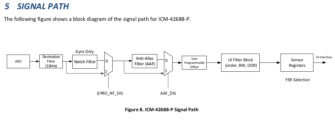

Improvements for ICM42688P. Looks like a nice sensor on paper and test rack, looking forward to get more data.
master ← pr-icm42688p_improvements
opened 01:59AM - 31 Aug 20 UTC

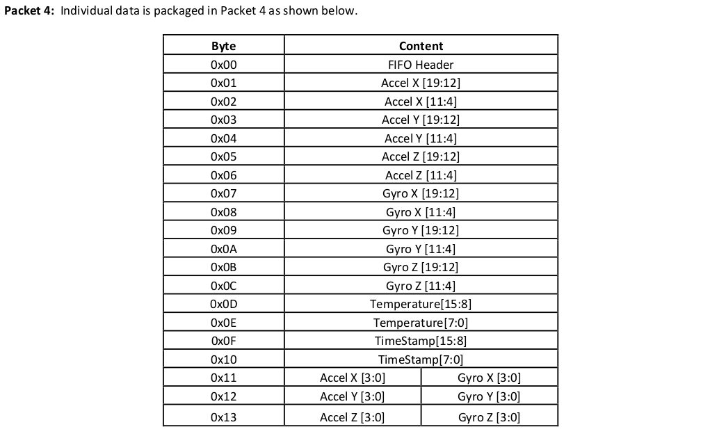

- use full 20 bit data (18 bit accel, 19 bit gyro)
- increase ODR to 16 kHz
… - disable all filters (anti-aliasing, notch filter, and UI filter all disabled or minimized for now until we want to set them intentionally)
The 20 bit data format is a bit weird (see below). To handle this and not grow our existing 16 bit sensor_accel_fifo/sensor_gyro_fifo messages I truncate the least significant bits as needed with a corresponding change to the scale factor. For example, since accelerometer data is is 18 bit dynamic range 16G it can fit within int16_t up until 4Gs.
