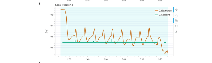

Consistent Z oscillation
This one is with a higher I value .https://review.px4.io/plot_app?log=5fdb1989-c684-4d41-9343-e3525520d304
and this one is with a lower I value,
Hi there!
  1. You seem to have enormous amounts of vibrations.
  2. Your rate tracking seems quite bad, could you rate tune your quad first?
