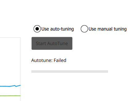

Autotune initializing ---> Autotune: Failed
I’m trying to do the autotune of my Octaquad Copter (Coaxial) running PX4 (1.15) over Pixhawk 6X .
My drone is almost stable with manual tune. Want to make it rock solid with the help of autotune.
Problems:
  • But, when I start the autotune, first it says “Autotune Initializing” and then after a minute or so it says “Autotune: Failed”, no reason on the screen.
  • My drone is just fine, it’s not crashing. Stable position flights of upto 15 mins.
  • With the little bit of wind speed (like 8-10 knots) my drone tilt and start fighting to maintain it’s position.
  • The drone isn’t staying level and it’s tilting towards the direction of the wind coming from. Without wind, it’s working absolutely fine.
I’m not moving my RC sticks after pressing the “Autotune” button.
Flight Log:
https://review.px4.io/plot_app?log=51697d1b-ccae-4a52-b59a-5f2df9ef485a
I tried this twice but both time it’s not working.
