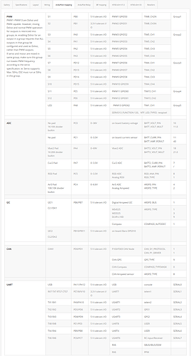

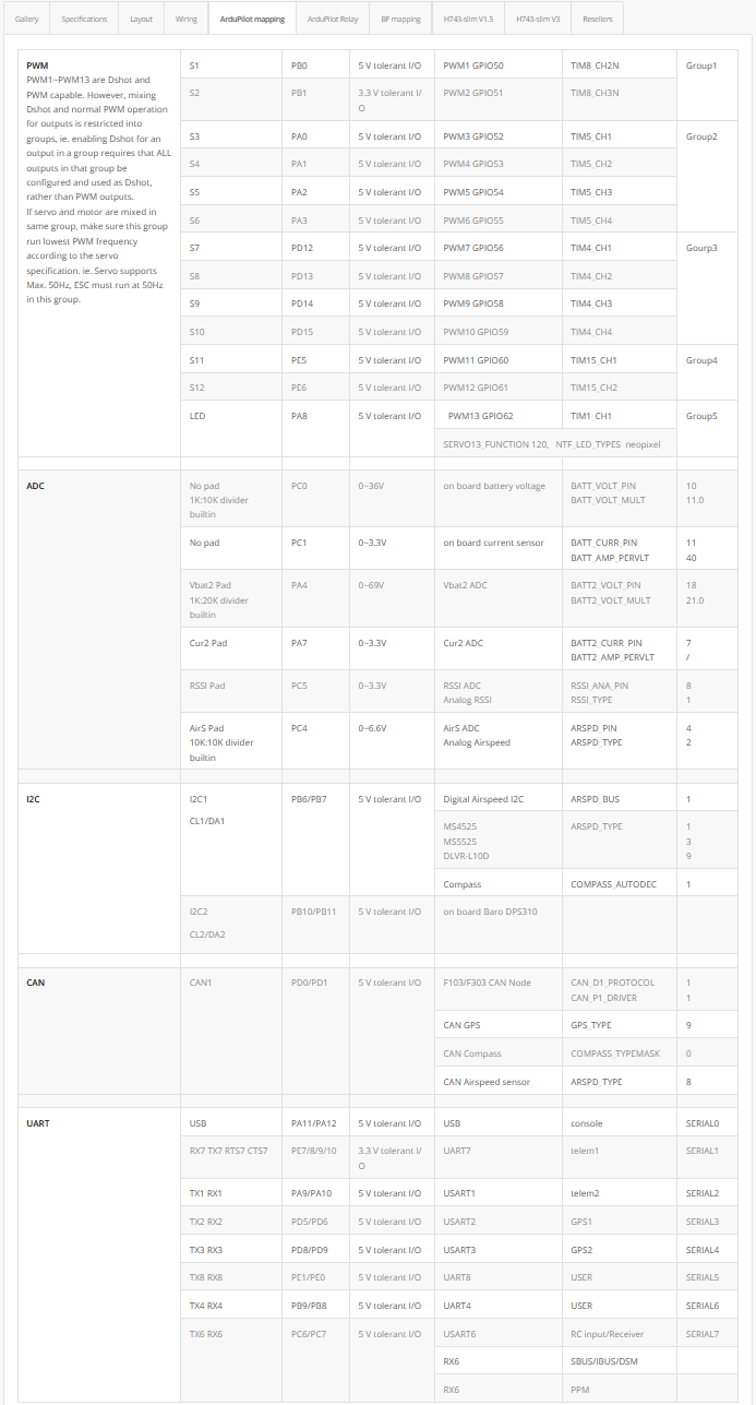

I have found this table on the Matek Homepage that I would like to check with the PX4 code:
The working motors are in Group1
Can you guide me / tell me if this is the correct thing to do in general?
