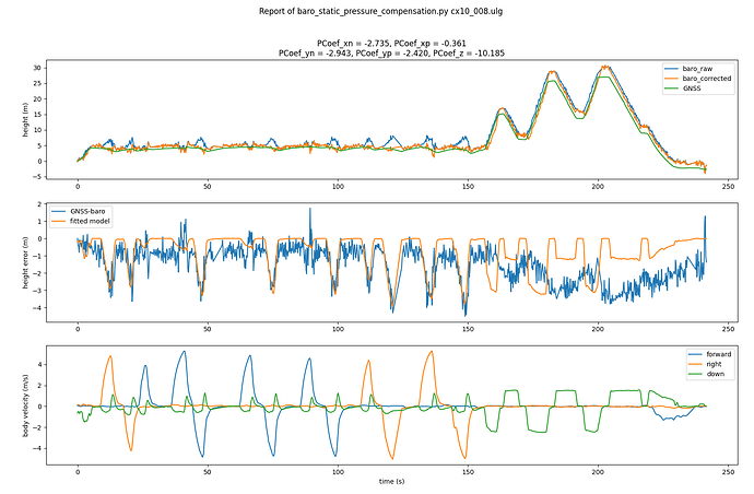

However, the estimated parameters for my drone are outside the allowed range even though the estimated corrections looks OK in my eyes. The height is still wrongly estimated when demanding vertical velocities, when compared to GP,S and is not corrected by the tuning script
Log (no wind): https://review.px4.io/plot_app?log=cb1a6965-07ad-4a1f-a2a1-59195b77638a
Tuning script output
Optimization terminated successfully.
         Current function value: 1810.789198
         Iterations: 441
         Function evaluations: 701
param set EKF2_PCOEF_XN -2.735
param set EKF2_PCOEF_XP -0.361
param set EKF2_PCOEF_YN -2.943
param set EKF2_PCOEF_YP -2.420
param set EKF2_PCOEF_Z -10.185
Questions:
  • Are these limits perhaps suited for smaller drones like x500 or should my larger drone also be in the [-0.5, 0.5] range, indicating something is wrong with my setup or flight?
  • Are drag specific forces tuning required before tuning the Correction of Static Pressure Error. The documentation states For multi-rotors, fusion of Drag Specific Forces can be enabled and tuned to provide the required wind velocity state estimates. ?
My goal is to have the drone not lose 2-4m altitude when braking to a stop.

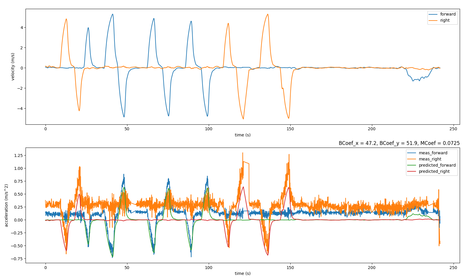

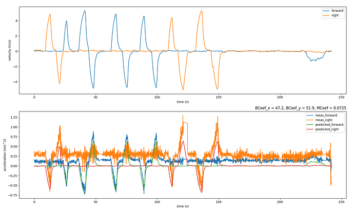

If it helps I also run the wind estimator tuning script.
Output when running mc_wind_estimator_tuning.py results in parameters in allowed range except EKF2_DRAG_NOISE which is below the minimum of 0.5.
         Current function value: 250.423765
         Iterations: 79
         Function evaluations: 141
param set EKF2_BCOEF_X 47.2
param set EKF2_BCOEF_Y 51.9
param set EKF2_MCOEF 0.07
/!\EXPERIMENTAL param set EKF2_DRAG_NOISE 0.05

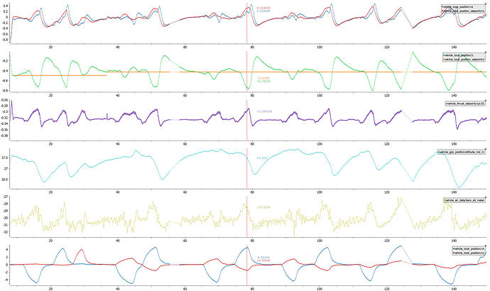

  3. Did you compare with another log if the results are somewhat reproducible? The pattern I usually fly is Altitude mode accelerating with full tilt in each direction and then letting it coast for as far as possible e.g. until it stops or I run out of space or visibility. Similar like for the drag, wind fusion which I usually do first.

From a quick glance at the log there seems to be a lot of barometer influence, the data looks somewhat noisy and the vehicle measures going up based on barometer with higher wind speed.

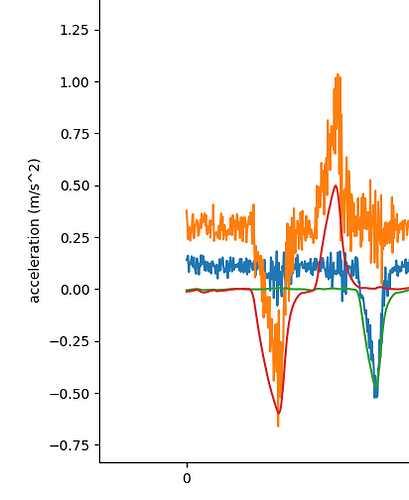

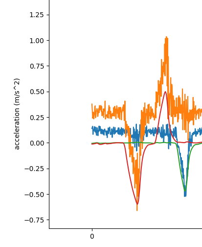

We can see that there is an offset of about 0.3m/s^2 (on the Right axis) between the predicted and measured accelerometer data. This would create a wind offset that can affect the baro compensation.
Do you also have a log with this tuning applied? We should verify that in calm conditions, the wind estimate should stay close to 0 regardless of the speed and direction of the drone.

Regarding the pressure coefficients, EKF2_PCOEF_Z is probably unobservable as you can see that the fit is really bad at the end of the flight, when you only perform altitude changes. → you can thus ignore that result and leave it to 0
You can also lock down this parameter to 0 in the script to refine the other parameters. To do that, add bounds to the optimizer:
`res = optimize.minimize(J, x0, method=‘nelder-mead’, bounds=[(-5,5),(-5,5),(-5,5),(-5,5),(0,0)], options={‘disp’: True})`

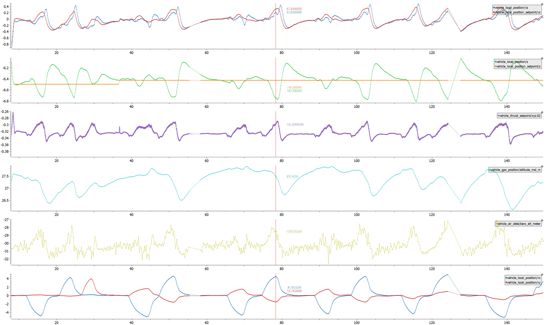

  1. I am certain it has to do with barometer error. I performed multiple flights today where I initially used barometer as primary height source EKF2_HGT_REF = 0 (baro) and observed the problem. I then switched to EKF2_HGT_REF = 1 (gps) and disabled baro aiding via EKF2_BARO_CTRL = 0 (disabled) , and did not experience the altitude drop to the same extent. Using baro drop is about 1-4m, using gps it’s below 0.5m, which isn’t really noticeable.
  2. Barometer is the internal Cube Orange+ which is mounted inside the airframe body (not an airtight frame but fraily water resistant (IP54). The body uses pressure/vent/moisture plugs to allow pressure changes and moisture to escape. It’s similar to this part form digikey. I am not sure how I can improve barometer placement, it’s not in the open air. Do you have any suggestions @MaEtUgR ?
  3. The phenomenon is reproducible between multiple different aircrafts. I performed some altitude flights with this in mind to test running the script with again. Here is a flight with the “Coasting”: https://review.px4.io/plot_app?log=ac9d0380-3089-4824-bab3-f9d3211a77ab

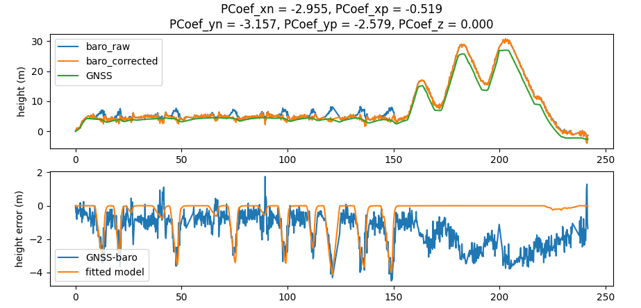

I adapted the tuning script with constraints on not optimizing Z and left out the height change region of the script, and got the parameters:
EKF2_PCOEF_XN -2.777
EKF2_PCOEF_XP -0.518
EKF2_PCOEF_YN -3.126
EKF2_PCOEF_YP -2.578
EKF2_PCOEF_Z 0.000
I then did two test flights:
  1. Without the compensation parameters: https://review.px4.io/plot_app?log=a98902d4-84fb-444b-b0b3-4a06cc9d7ffc
  2. With compensation parameters: https://review.px4.io/plot_app?log=3943ee98-446b-4d8a-89b6-a7daedeaa6e0
The problem was not mitigated nor reduced, only when switching to GPS is it solved (EKF2_HGT_REF = 1 (gps) and EKF2_BARO_CTRL = 0 (disabled).

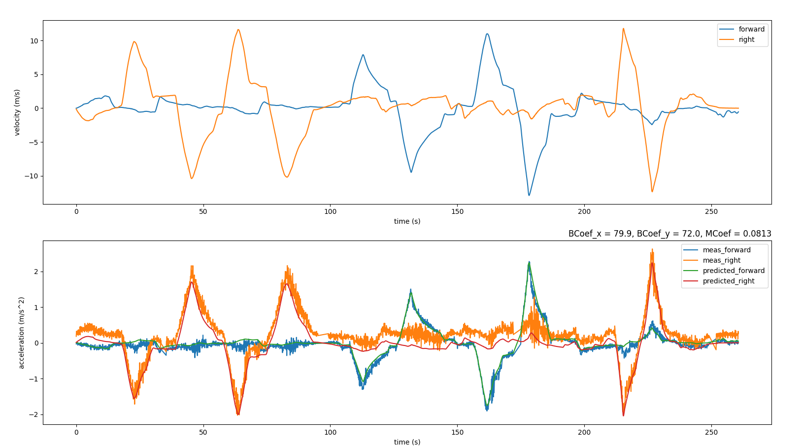

With a correct wind estimation tune using EKF2_DRAG_CTRL, EKF2_BCOEF_X, EKF2_BCOEF_Y EKF2_MCOEF and EKF2_DRAG_NOISE the estimated wind estimate should be close to 0 even if the drone is flying with some horizontal / vertical speed. The estimate is just the wind speed then, make sense.

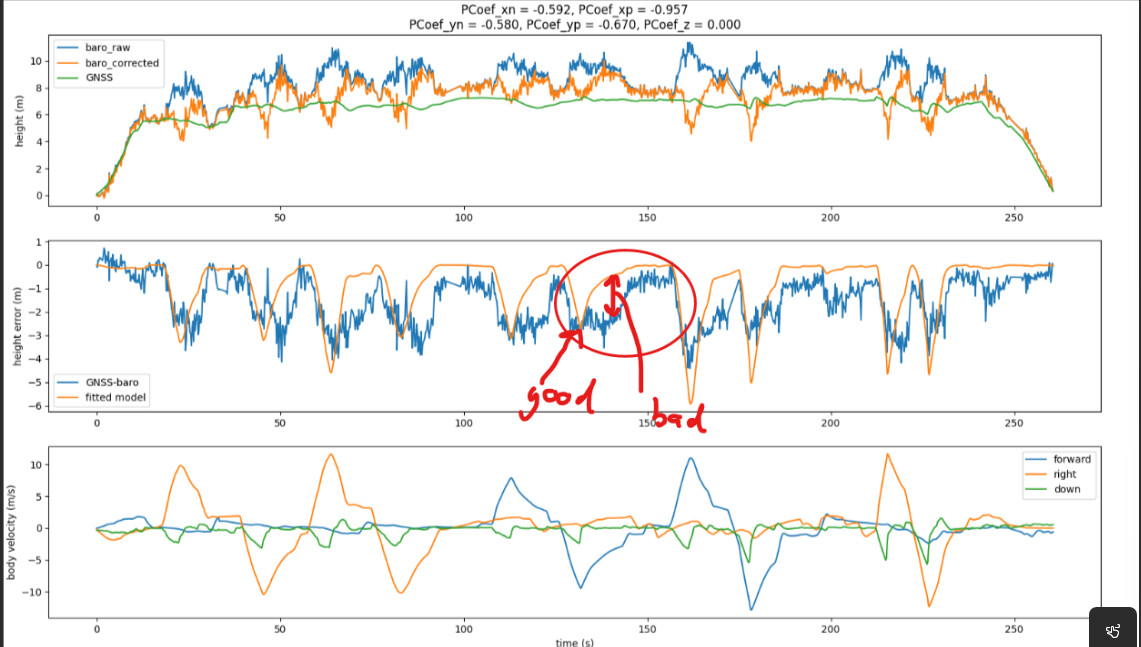

Using the “coasting” flight (higher velocities, no sudden stops, just coast until stop) the parameters are a lot closer to the suggested range by PX4 documentation, but the estimate looks worse in my eyes. Especially since the fitted model only estimated the error well during the dynamic part and not the coasting, see my red mark. Could there be a problem with my airframe? Perhaps my slightly “sealed” box doesn’t change pressure fast enough and the built up pressure takes time to be released?
EKF2_PCOEF_XN -0.592
EKF2_PCOEF_XP -0.957
EKF2_PCOEF_YN -0.580
EKF2_PCOEF_YP -0.670
EKF2_PCOEF_Z 0.000
Using the same log for wind estimation seems to produce reasonable results.
EKF2_BCOEF_X 79.9
EKF2_BCOEF_Y 72.0
EKF2_MCOEF 0.08
EKF2_DRAG_NOISE 0.04
The drag noise is however, a magnitude lower than the minimum suggested in PX4 Is it still a reasonable number? @bresch EKF2_DRAG_NOISE = [0.5, 10] (2.5 default) (m/s^2)^2
