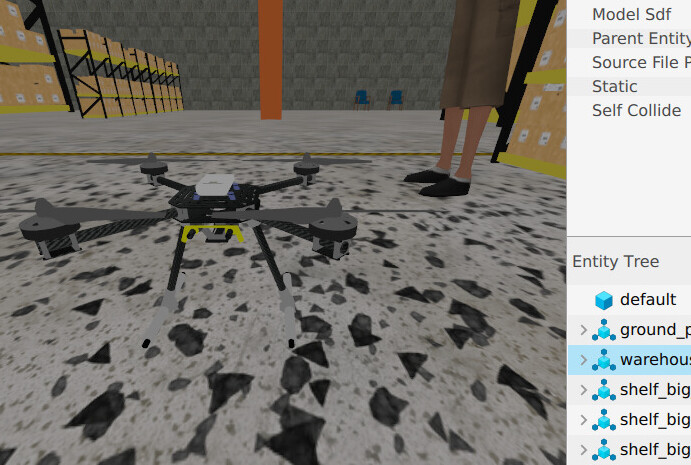

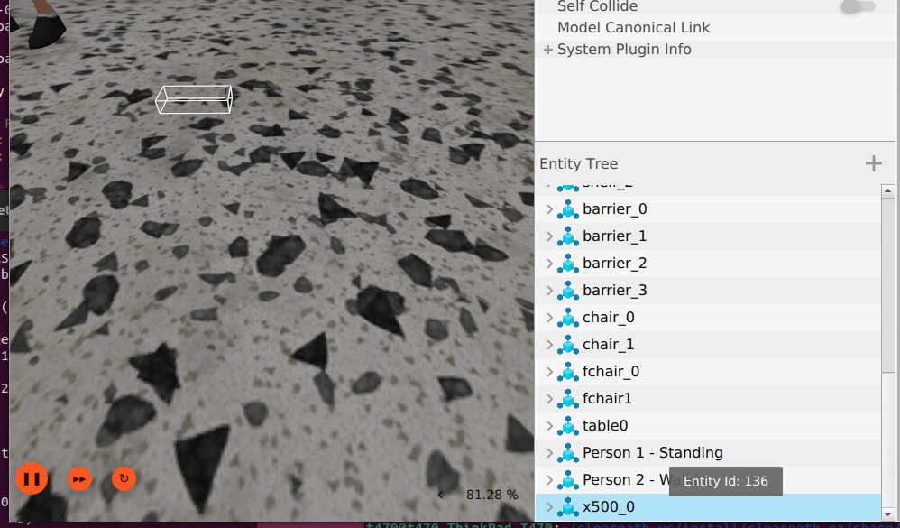

Please refer to screen capture. I don’t see the vehicle even though it is showing in Entity Tree. Would you please let me know how I should troubleshot this?
