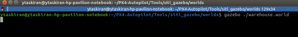

I’m having trouble while using gazebo with px4 (without ROS). When I run the command
    make px4_sitl gazebo
It works normally: gazebo opens and px4 runs.
However, if I want to open another world on gazebo with
make px4_sitl gazebo_iris__warehouse
It stucks at this point and gazebo does not open as well as px4
If I try to open the world manually just with gazebo like this, gazebo is not opening again
The thing is, some simple worlds works without problem like empty.world, boat.world.
But more complex ones does not work. I dont think the reason is my system. I don’t know gazebo or px4 causes the problem but default gazebo worlds I tried has worked so far. My best guess is this is some kind of plugin problem. I appreciate any help you can provide.

Hello again, quick update
gazeboprobsolve
As can be seen above, in the warehouse.world file, the accessories part models does not exist in the corresponding model folder. When I deleted this part, gazebo worked seamlessly.
I could not find the files in the PX4-Autopilot repository as well.
Is there anyone who knows the reason why these files does not exist in the model folder while the script tries to call it?
@ytaskiran It is not supposed to be there, and it will be automatically pulled from the gazebo model database. That is why I asked you to look at the debug outputs of gazebo by adding VERBOSE_SIM=1
