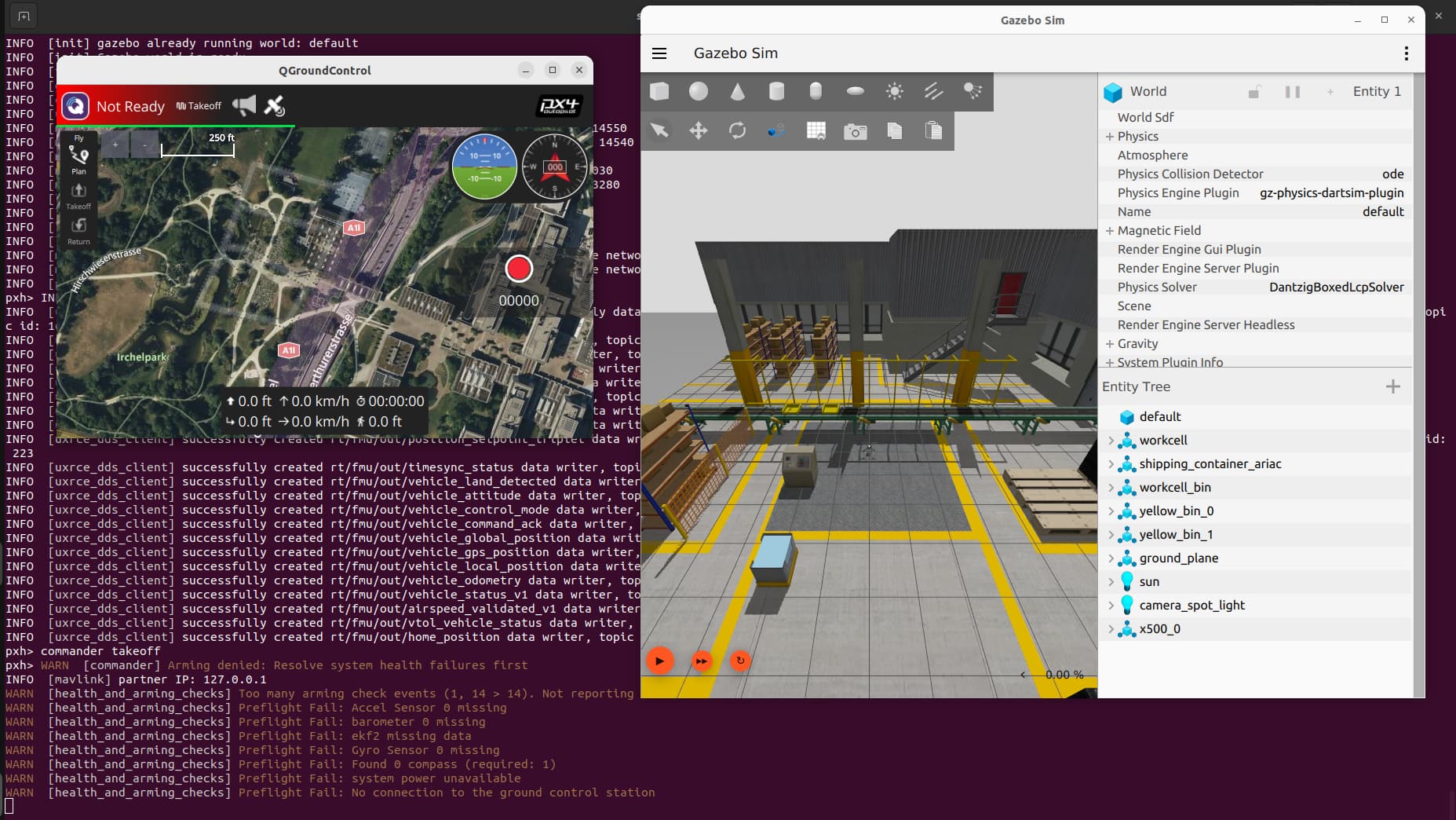

  • This setup successfully spawns the x500 inside the warehouse world , but cannot arm due to health check failures. commander takeoff returns:
pxh> commander takeoff
pxh> WARN  [commander] Arming denied: Resolve system health failures first
  • Also, I confirmed that there’s no present for libgz_px4_bridge.so

I’m looking for the correct way to automatically build or load the libgz_px4_bridge.so plugin when using PX4 with Gazebo Harmonic. With my custom warehouse world, even when I manually launch Gazebo first and the x500 spawns, PX4 doesn’t allow arming or takeoff due to missing health checks. Any advice on fully integrating this world into PX4 SITL with proper sensor simulation, bridge loading, and automatic model spawning would be greatly appreciated.
Thanks in advance!
You should change the world name from default to warehouse. You also need to connect a ground control station.
