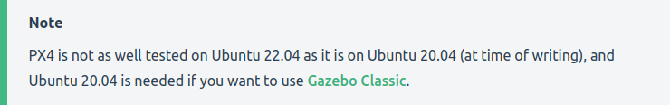

So I need px4_sitl to simulate the drone and control it. For me, there are 2 choices, one is Gazebo Garden and one is Gazebo Classic, which according to the description of the official document of PX4, Gazebo Classic does not work on Ubuntu 22.04.
which is in the link below:
https://docs.px4.io/main/en/ros/ros2_comm.html
