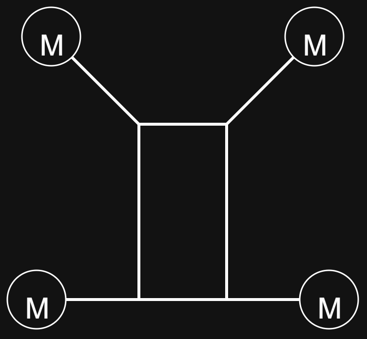

Hi everyone, I’m building a quadrotor with the specific geometry shown in the attached image. I am using PX4 and configuring it via QGroundControl.
Since this is a hybrid design, which airframe type should I select as a base in QGC?

Hi!
Quadrotor H
or
Quadrotor X
would be a good starting point. You can then adjust the geometry of the airframe in QGC: Actuator Configuration and Testing | PX4 Guide (main)
